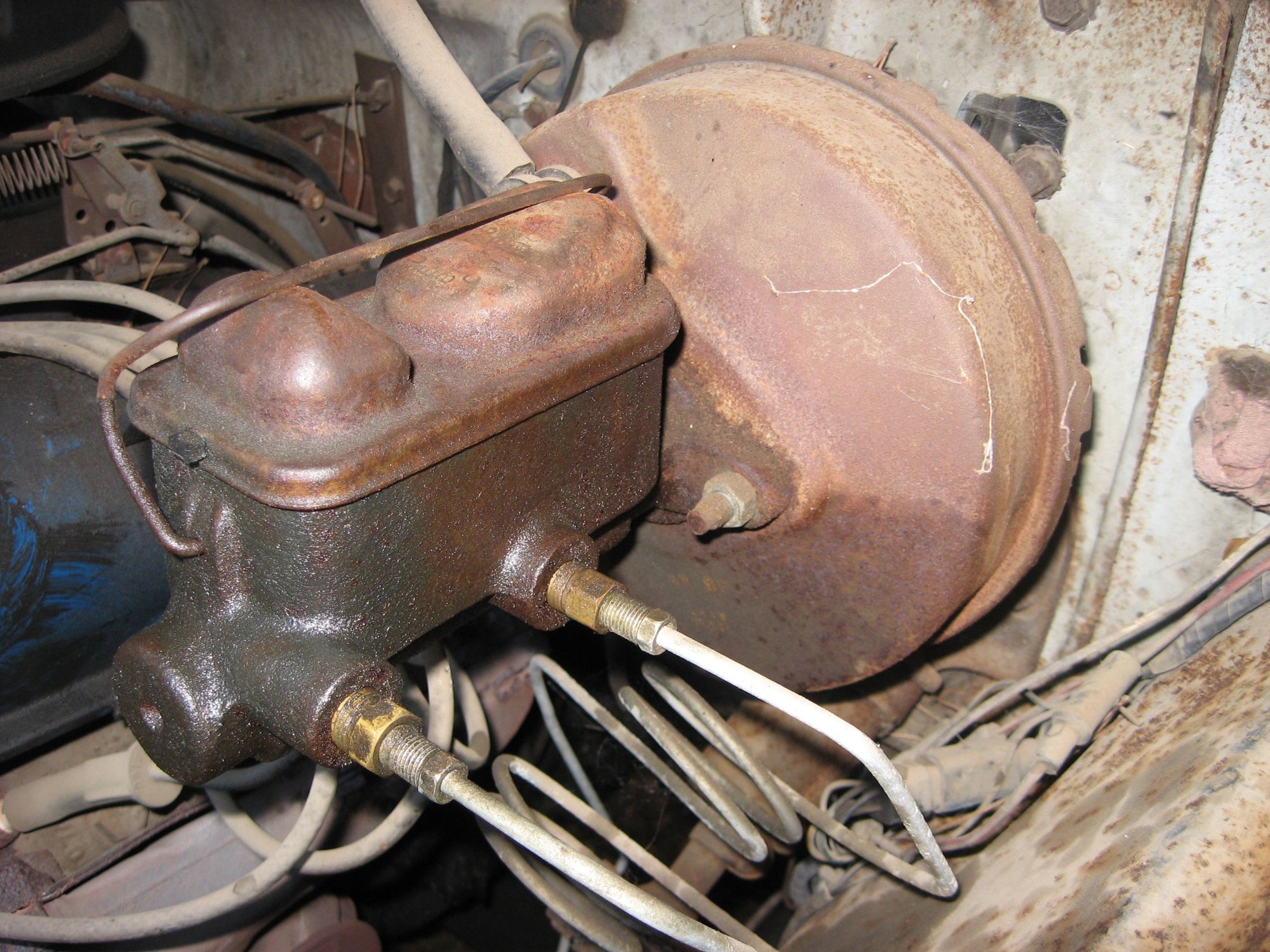

I also wanted to upgrade the non-power brakes on my 67 F250. Since PB was offered in 67 I went to local NAPA and ordered a completer rebuilt unit that consisted of master cylinder and power booster. I wanted the complete assy to make sure that both were compatible. Some issues with push rod? Normally I would order a new MC. At first the counter guy was not sure if it was available, so he checked his books! Anyways he ordered the unit.

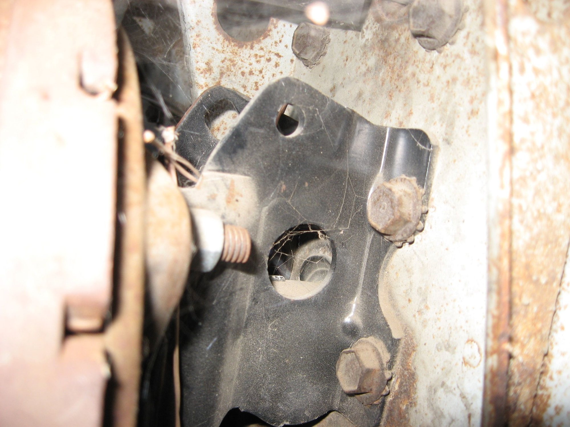

To install the unit I went to local pick pocket your part and found the 2 adaptor plates. The only thing I had to fabricate were the 2 hard lines to the distribution block. Very simple.
BTW - Hope the pix show. This is first time to resp with pic's. The OEM PB works great - Bob
From what I understand to upgrade drum front brakes to disk brakes is way more involved. Hope this helps - Bob

1967 OEM Power brake works great - Bob

I am still learning this site. Hopefully I have attached the brackets necessary to add the power unit to the truck. I believe these can be found on evilBay. - Bob
