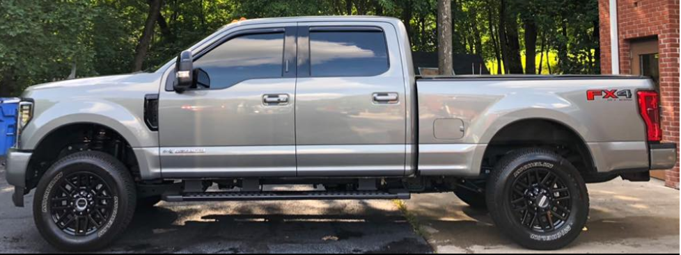

Went with the 2.5" Readylift level spacers and track bar bracket. Posted to forum and was recommended and actually called Readylift directly and spoke to a agent that was awesome. Told him everything he recommended which kit would be best and explained why others would work but would not best best esp since adding snow plow and have prep package. Great experience all around and they even do military/first responder discounts if order via phone! Have not had a trailer yet on the truck to weigh in on that part yet.

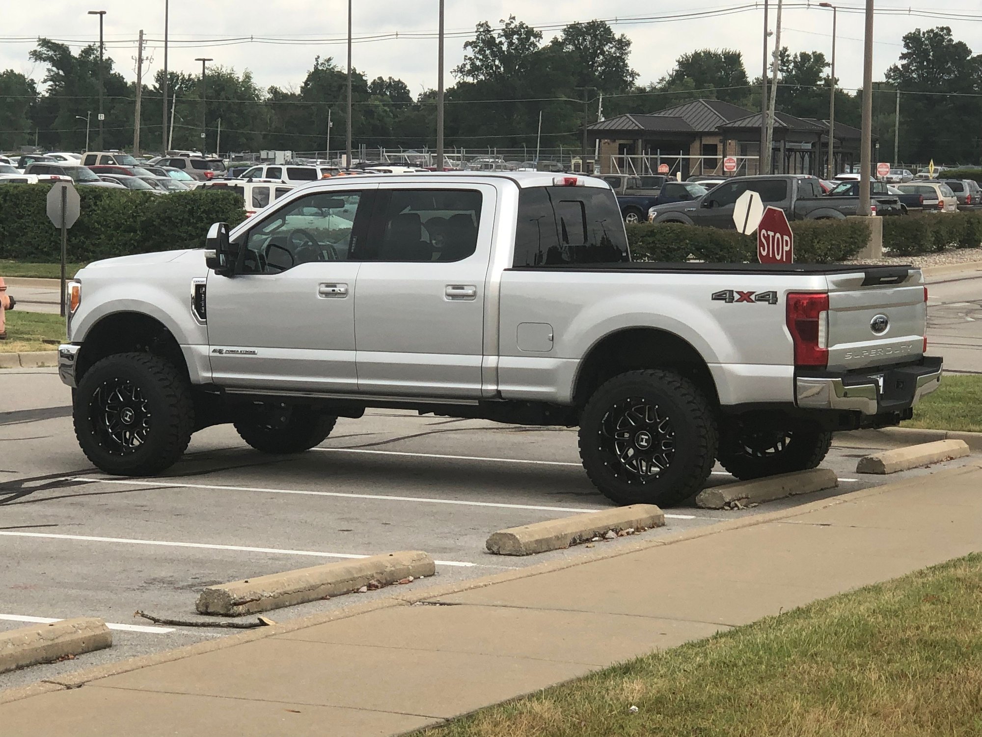

I also did the ready lift 2.5 with fox shocks. Sits perfect to me and only drops about 2in with my 28 ft. bumper pull with no bars attached. I could have used stock shocks with no issues.

These are the stock tires on your truck correct? I was thinking of getting this ready lift kit. I just got a 17 with only 7k miles and can't justify new tires just yet.I was worried it would look bad without the larger tires. I think your truck looks great though. I'm thinking 35s or 37s for me.

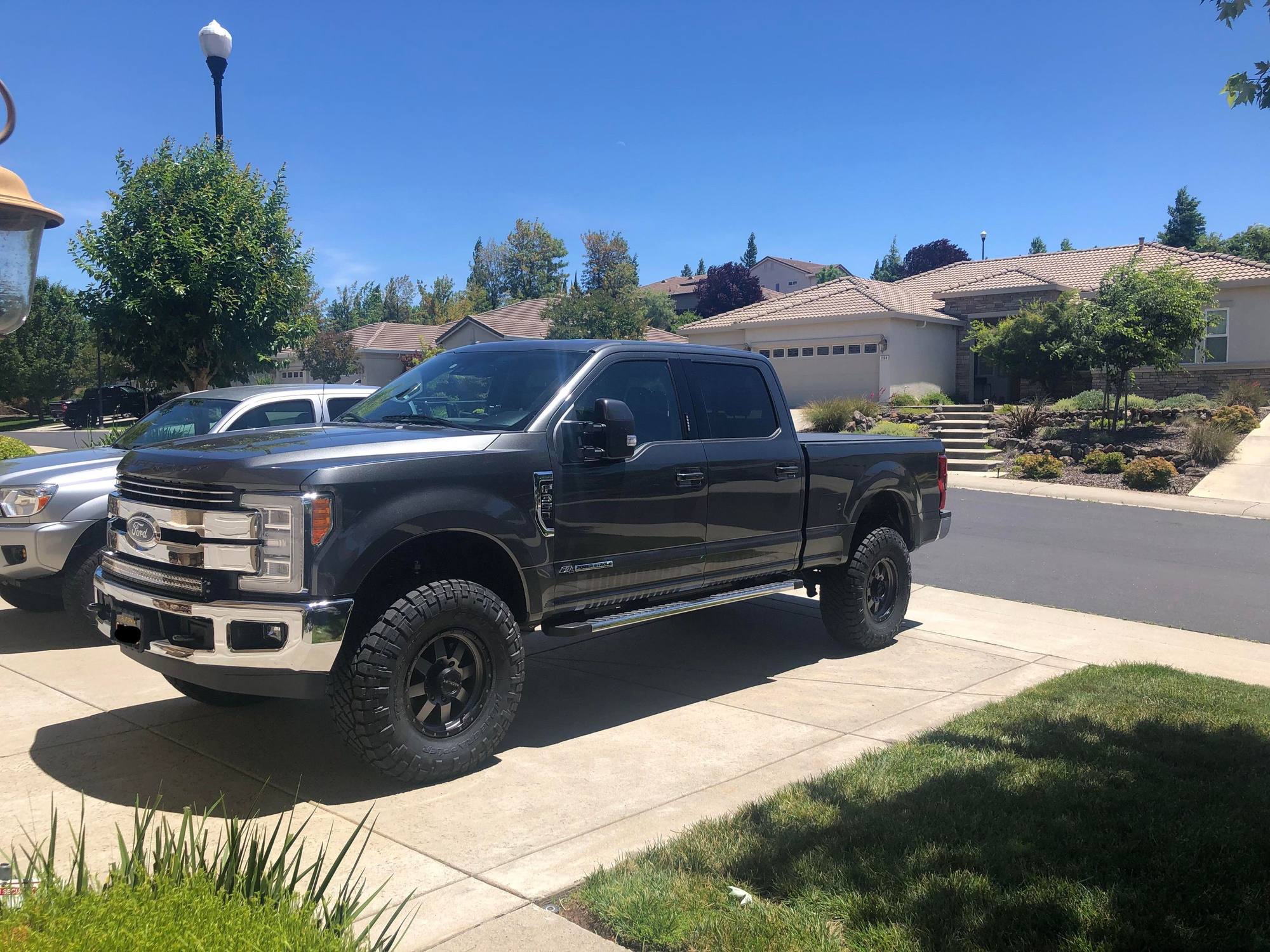

Carli commuter 2.5" level with fox 2.0's all the way around. Huge improvement over stock!

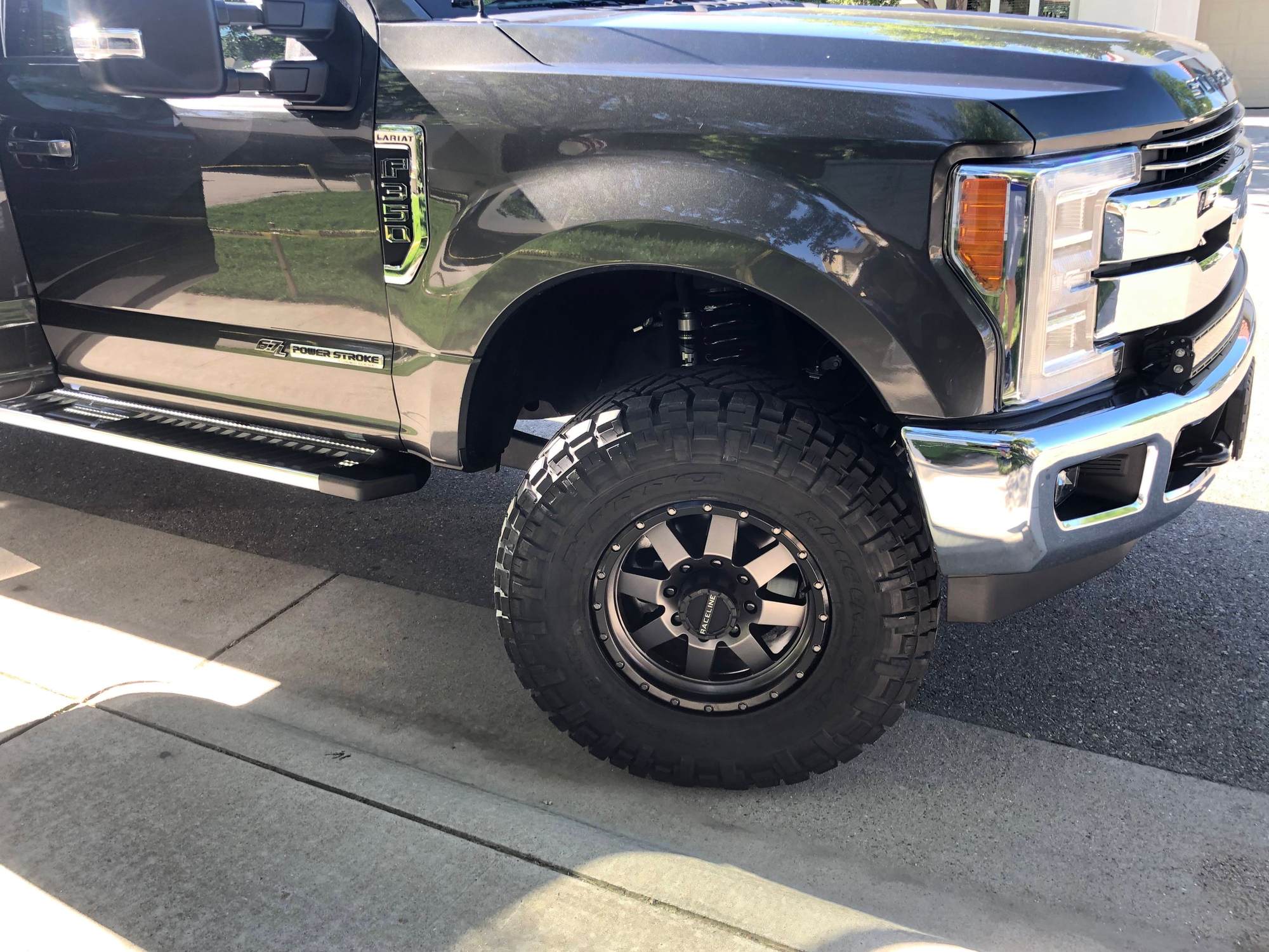

We also used the 2.5" ReadyLift kit. But my installer also added a small spacer with it (from a GM IFS) kit that is not quite 1/4" thick. I used an adjustable track bar which allowed us to perfectly center the front axle. The truck is almost perfectly level now.

@Evilgenyus Yes that is correct stock wheels and tires....I am same way cannot justify new tires yet....I plan on 35s when due for tires!!!!
