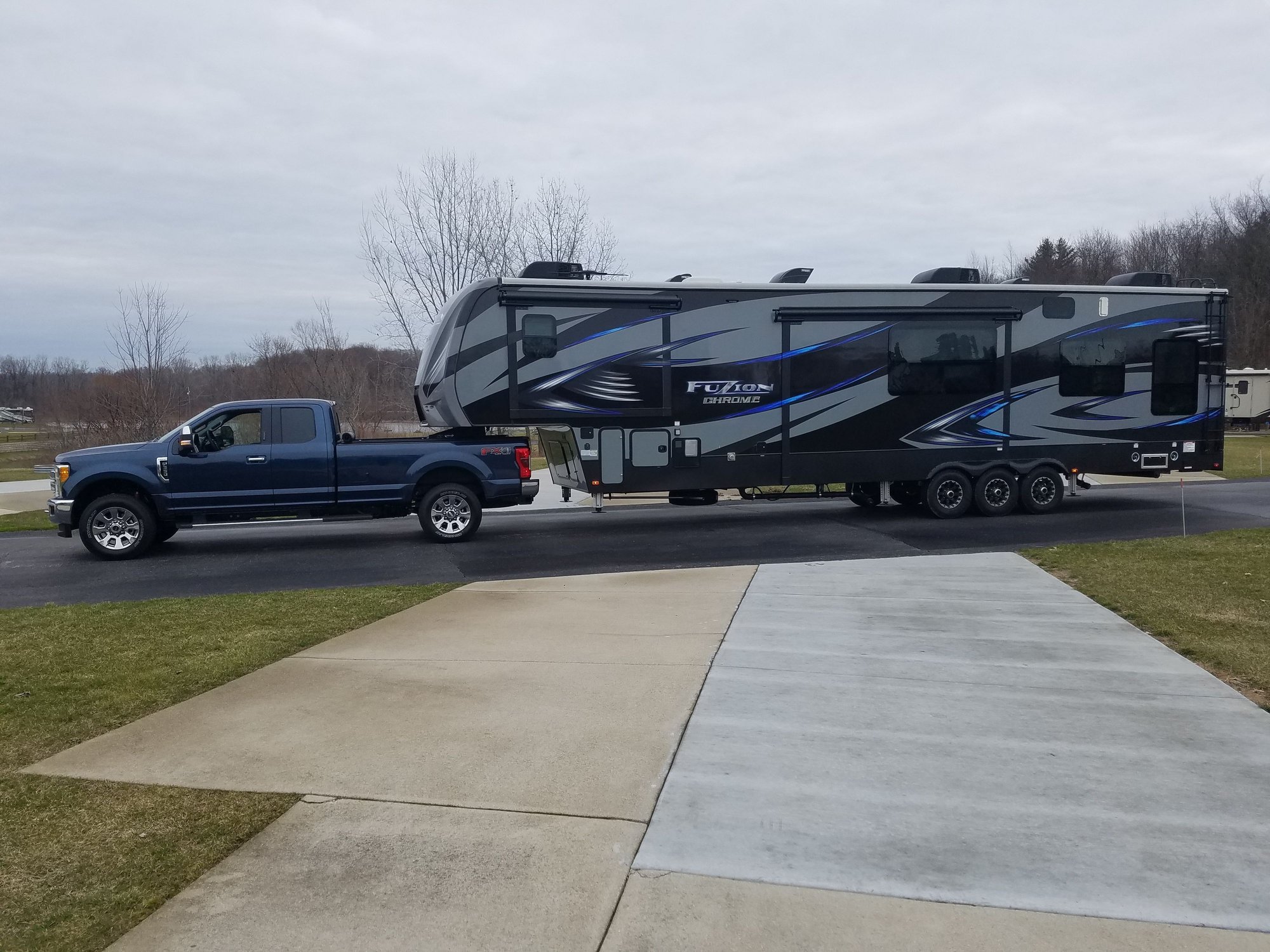

I disagree, I put my 18k 5er on my 350 SCLB and it levels it out. no sag just level. I have bags because I thought I needed them. I will use them when I put my level kit on.
Post pics when you get your leveling kit, I've got the same setup truck wise mine has the plow prep package though. Like to see how it sits.!
