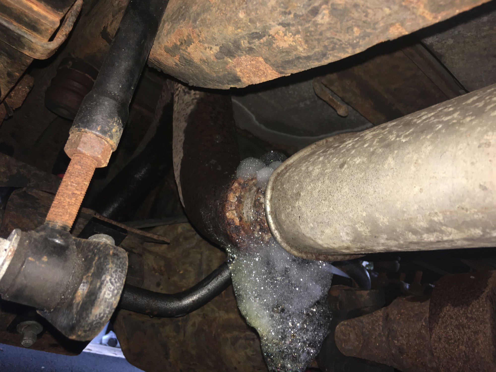

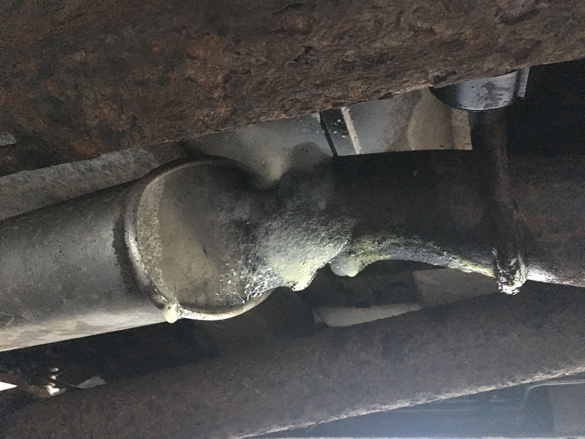

In tracking down exhaust smells that were making their way into the interior cabin I found leaks at both ends of the stock muffler pipe
joints.
We use the Ex for long trips with the kids and often towing a camper so I’d like opinions on what would be the best option for the least amount of exhaust noise and secondarily better mileage/performance:
(a) seal the leaks with exhaust putty/tape
(b) delete the muffler
(c) replace the muffler
any specific product recommendations for (b) and (c) would be much appreciated.
