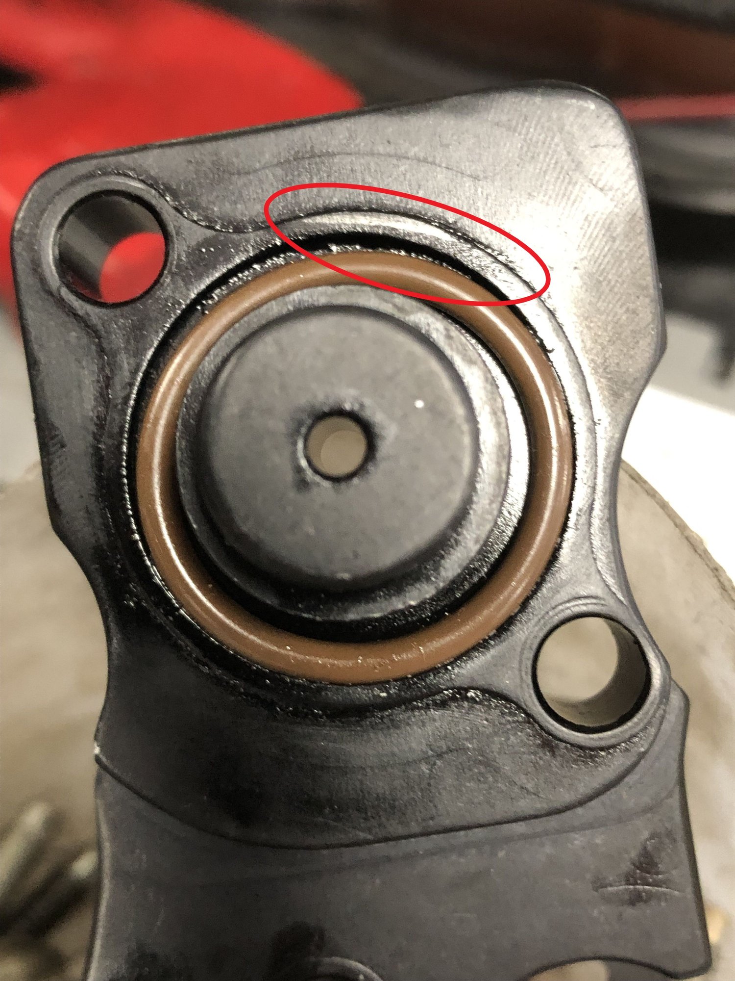

Originally Posted by Chuck-B
Well folks, I'm happy to report that the debacle has ended. I have a 2015 CP4 pump, and Exergy module, new fuel lines and the sensors on the fuel line; no DPK. Took everything apart and inspected the 2 places Exergy said to look. The o-rings looked fine. We did see a ware spot (see picture) on the DPK in 1 of the spots Exergy said the problem was probably occurring. I called Exergy when the truck was apart and asked if I could replace the slightly used Exergy module that is in the 1st pump with the one in the new pump they sent. They gave me the "ok" to do that. So now we don't know if it was the DPK that was bad or the Exergy module that was bad. Exergy asked me to send them the DPK, their new pump with the slightly used Exergy module in it and they will test the setup in their lab to see if they can determine where the problem is. I wanted to go overboard on protection having the Exergy module and a DPK. I totally am not going to tear the truck apart again and put a new DPK in. It's life with a '15 CP4 and an Exergy module to protect the injector system.
Also looks like no tuning is needed when putting a '15 pump in a '11 - '14. Truck is running perfectly. Brought it up to temperature, jumped on it, went through the gears 2nd to 6th each at it's little over 3,000 RPM shift point and no CEL. Thanked everyone at the shop, was all smiles and then drove home through town 20 - 35 mph in 90 degree heat. Turned onto a side road, jumped on it again going up a fairly substantial hill, 3rd to 4th and 4th to 5th at it's a little over 3,000 RPMs shift point and it did fine. Took a bit longer to get up to the 3,000 RPM + shift point pushing itself up the hill. Ran out of hill to get it from 5th to 6th. No CEL, I'm satisfied we resolved the issue.
At some point I will tear the '13 CP4 pump apart to see if my debacle was warranted. Going to wait a bit and let the new pump, new fuel lines, the sensors in the new fuel lines and the Exergy module settle in a bit. Once I start tearing the old CP4 pump apart, it's not going back together.
Also want to think the folks here for their suggestions, well wishes and willingness to help - thanks folks!!
hey chuck names Dave I have a 16 f350 and just put on an xdp prevention kit and I’m getting a p228f code for fuel pressure too high was wondering if you ever got a definitive answer from xdp about what’s happened. We reused the stock mprop and I’m thinking that may be the problem any help would be great gonna start a new thread too if I can beings I’m new here
