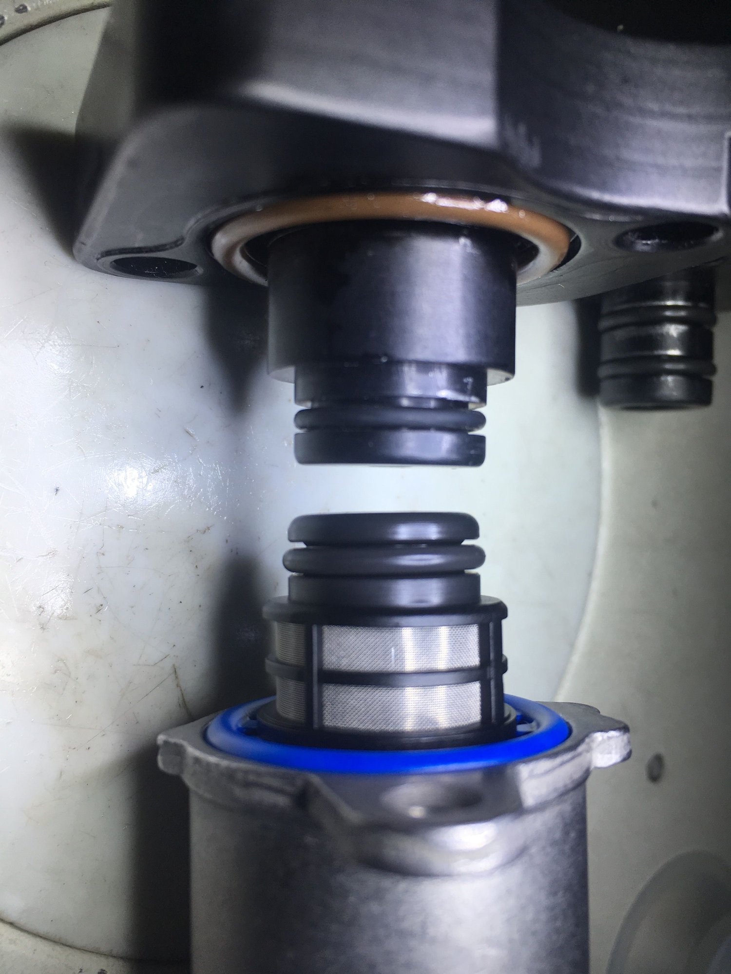

Verdict is in and it's not the o-ring we thought it was. Also nice picture of the screen Exergy adds to their modified module.
Test #1 - Original System Saver Valve - Without XDP kit - Ran normal, passed calibration test
Test #2 - Original System Saver Valve - With XDP kit - Pump output did not change as valve current was adjusted - failed calibration test
Test #3 - New System Saver Valve - Without XDP kit - Ran normal, passed calibration test
Upon further investigation I was able to determine the root cause. The XDP kit has the wrong size o-ring installed where there machined piece seals in the MPROP (system saver valve) cavity in the pump. See attached comparison picture which shows their o-ring (too small) compared to the valve it replaces. The OD of the o-ring is ~1.5mm smaller than what it needs to be, so it doesn’t seal against the pump case. This allows fuel to simply bypass the metering spool in the MPROP which does not allow the valve to serve its purpose.
That's crazy Chuck, but great find. They screwed up there. You contacting them about this?

so question for XDP , is this a one off or is there a material defect in the product? I don't see a happy ending yet until some final answer is disclosed (material defect in a casting run, new hire included the wrong o-ring, product not compatiable with XYZ year, etc, and /or problem resolved.
the CP4 bypass is a great idea, but if it cant be executed, its just an illusion.
I was going to buy one...but I don't need these headaches ...it needs to be a drop in and go.
please advise
This seems to be an isolated incident. We just opened a bunch of inventory and the o-rings were sitting properly in the machined adapter (unlike the image shown above). I don’t have Chuck’s specific kit back in our hands yet, but we will thoroughly go over it when we do get it.
At this point it’s likely this was some sort of one-off machining error, or an issue with the o-ring seal. The ownership, manufacturing, tech support, and QC teams are all aware of this issue and are on heightened alert.
