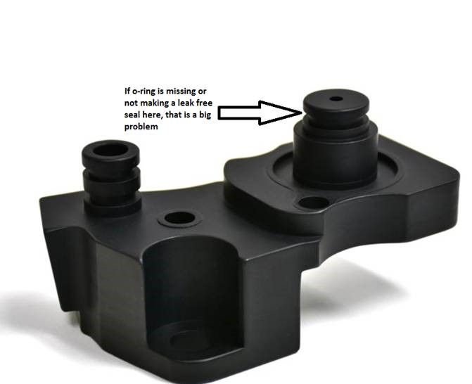

Here is a picture of the other location they wanted me to check

The first pic shows where your mechanic would have installed the Exergy valve into the disaster kit fitting after removing it from the new CP4 pump. This is a tight fit even using lubricant and if pulled into place while tightening the bolts could have damaged one of the orings on the new Exergy valve. The second pic shows the bottom of the disaster kit fitting and the arrow is where that fitting seals into the CP4 Pump in place of the fuel metering valve and also a good place to look for oring damage. The fitting on the left side of that pic is where you either use the original orings off the now discarded fuel supply line that was cut to install the kit or new orings supplied with the disaster kit. If using the kit supplied orings and they aren't color coded to the original fuel supply line orings it's possible to install incorrectly as they are different size. I attached my kit install pdf as it shows color pics of the orings mentioned above. I used a S&S Diesel kit so oring colors may be different but have found reading install instructions from a different viewpoint is sometimes helpful. One last thing is to make sure they torqued all the bolts on kit and valve as these parts are critical to be properly tightened. Hope some of this makes sense and helps out a little.

Helps a bunch, thanks. I have the piece of line, it still has a green and yellow o-ring in it which leads me to believe the DPK came with o-rings. I was ‘helping’ with dissembling and reinstallation and do know he torqued the bolt. I must have not been paying attention when the DPK was installed as I don’t remember him taking the Exergy module out of the pump. I might have been off BSing with someone. I do remember him torquing the bolt on the DPK though as that bolt is longer than the one on the stock set up and he was looking for the bolt.
