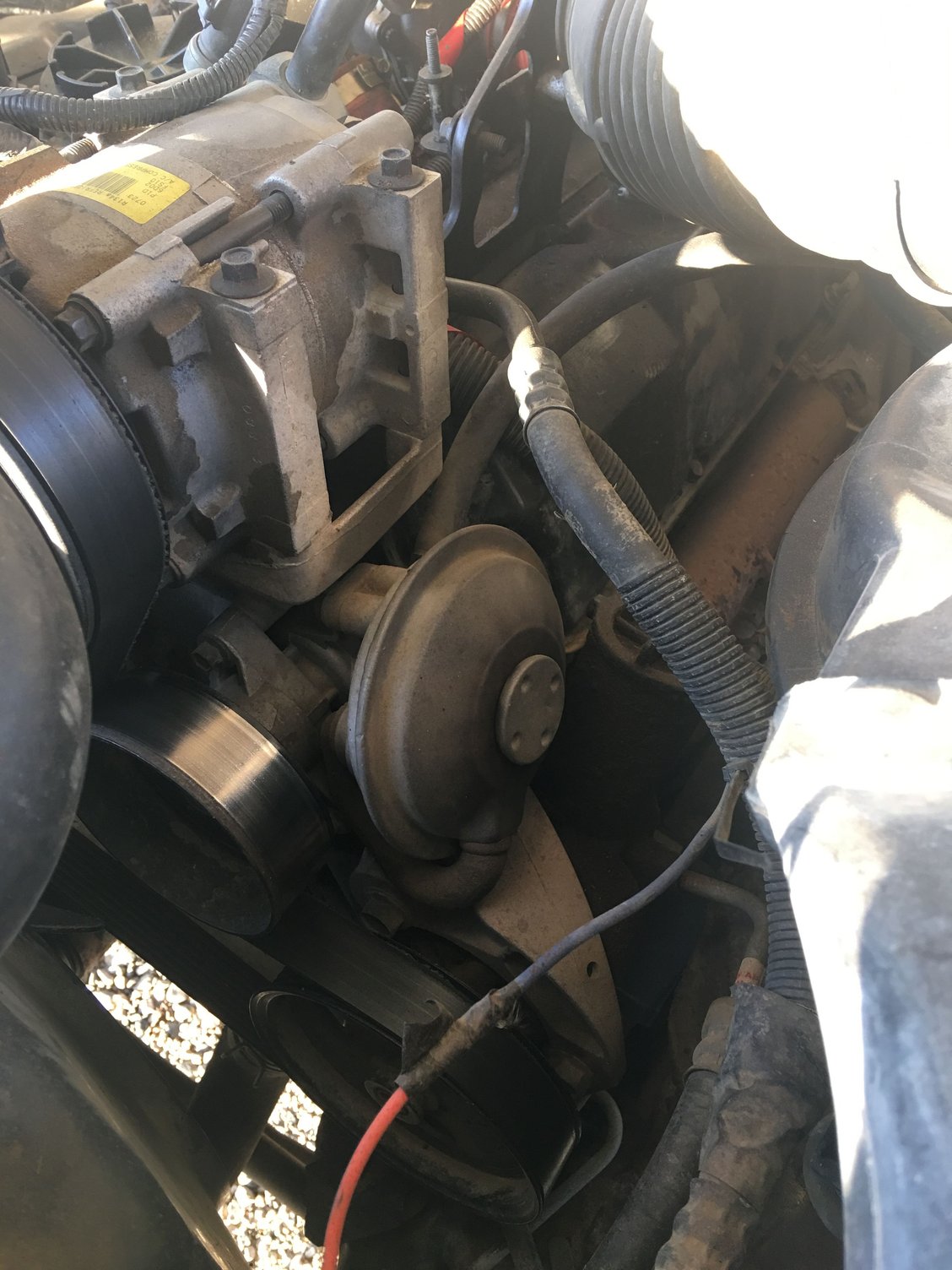

So somewhat random, but can anyone identify what this particular part is that is mounted just below the AC compressor, above the PS pump? About 6” round with a 1.5” round almost cap looking part. Has the four dimples on it.
Really what I am also questioning is that round cap part rattles and vibrates up and down, can hear from inside the truck. Was not sure if that was normal as I don’t recall hearing it in the past, but not sure when it started if it did.

That sir is your vacuum pump, it operates your brakes and anything that needs vacuum.

If you replace it make sure you install studs, theres a bolt that is very difficult to remove and install (you have to remove the pulley) with studs no need to remove the pulley.
They have the same thread as a 5.4 2v exhaust studs and work great, thats what I used.

Thanks everyone. Guess my next question, should you hear/see the cap bouncing up and down?

It should be smooth. Replace in doubt, you can be stranded...ask me how I know.
Replace PS high side line while in there

Bugger, seems the pulley is running fine, which is what a lot of people saw when failed, so at least have that going for me. Otherwise yeah, that little round cap just vibrates/bounces up and down like crazy and can hear it rattling while sitting idling.
Guess Is that is the next fix, thanks.
