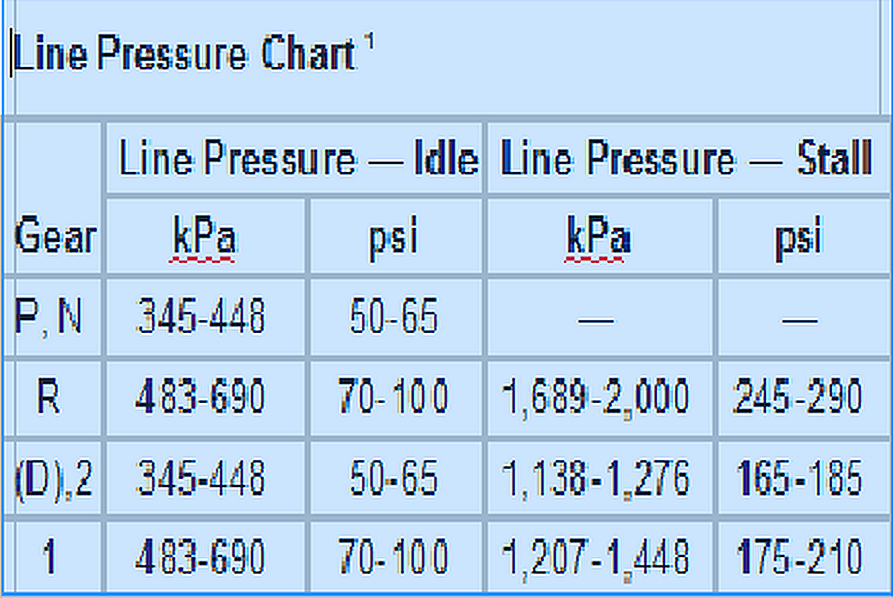

Get a 0-350 PSI gauge with a 1/8" NPT thread. Install it in the test port on the driver's side of the trans. Check the pressure with the engine at idle in PRND21. Also check it in RD21 at stall. Stall is in gear, left foot HARD on the brake, and the right foot holding the go pedal on the floor. CAUTION: DO NOT HOLD STALL FOR MORE THAN 5 (FIVE) SECONDS AT A TIME! Idle or fast idle in neutral for at least 30 seconds between stall tests.

Yeah everything reads normal still does it though
