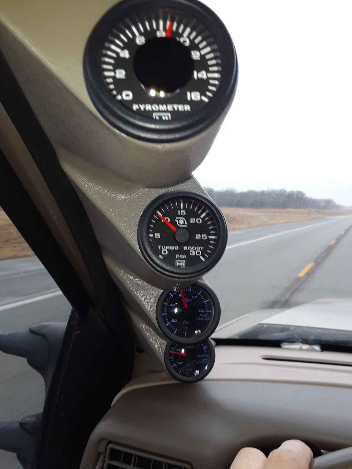

Pic of my pillar showing EGT (870*), Boost (9.7#), post filter Fuel Pressure (61#), Oil Temp (170*) while towing 10.5k 5th wheel in 6th gear
