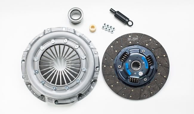

I have the 1939-OHD which is the same clutch as the 1944-60K-HD, but without the flywheel from SB. My clutch engages/disengages high in the pedal travel. I would say about 25% toward the floor (from the dash) the clutch will start to disengage and fully disengaged by 75% of pedal travel toward the floor. Vice versa with engagement.
Often times when sitting at a light, I will bring the pedal up from the floor to about 30% or so. I rarely push the pedal to the floor, but I do push to the floor on startup.
Different strokes for different folks though... I am very happy with the SB clutch and would and have recommend it to a friend. Good thing we have the ability to shop around and change the parts out as we see fit.

You could be right... I seem to remember that the SB rep told me over the phone when I called for advice that the 1944-60K-HD and the 1939-OHD were the same clutch, but the 1939-OHD was designed for owners reusing the OEM flywheel after it has been resurfaced. That was three years ago though and I have consumed many cold, frosty beers since then and slept, so I could be wrong.
1939-OHD
1944-60K-HD

Looks like they both use the same hub now, a few years ago they were different. The 1939 looked more like this.
