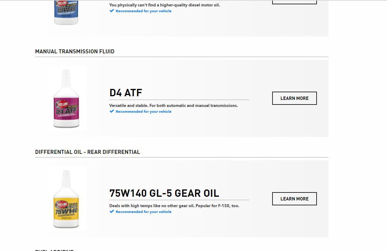

@beachcamperf250 If you go to www.redlineoil.com and put in your vehicle information at the top of the screen, then select "products for my vehicle" you will arrive to a screen that looks a lot like this one.

Called and talked to red line yesterday. I was transferred to someone more knowledgeable when I started asking questions.
They recommend the D4 atf as it is what follows Ford and ZF original recommendation. https://www.redlineoil.com/d4-atf data sheet https://www.redlineoil.com/Content/f..._PROD_INFO.pdf
I also inquired about the High temp atf https://www.redlineoil.com/high-temp-atf data sheet https://www.redlineoil.com/Content/f..._PROD_INFO.pdf
and MTL https://www.redlineoil.com/mtl-75w80-gl-4-gear-oil data sheet https://www.redlineoil.com/Content/f..._PROD_INFO.pdf
Explanation I got was any of these 3 would be good to use in a zf6 in my truck. D4 is the regular synthetic atf, High temp atf is thicker, MTL thicker yet. I am probably going to use the High temp atf when I get my "new" trans in the mail someday. (currently on it's way back to Florida so they can send it to Illinois. (no roads from Kansas City or Denver to Illinois apparently)) My thought as to why are below but I am always looking for other peoples opinions and experiences.
1 The high temp atf is the middle of the road between the regular atf and MTL
2 It is going in a "new" transmission. It should not need extra thick fluid than what ford put in back in 99. I better not have any shifting or noise problems I am trying to improve with a change of fluid since this is rebuilt and that seems to be some of the reasons that MTL is used by us.
3 All star standard says use synthetic atf. They rebuilt it and I am following what they say with the high temp atf so if I have a problem I am not worried about any warranty being denied due to the wrong fluid. No clue what they would say if I used MTL and had a problem.
4 I looked up the citgo mercon v I was using and it is thinner than any of these.
5 Highest viscosity index of the 3 I am considering. I am not educated on it but the engineer for the lubrication division here at work said he liked that one because of that when I showed him the spec sheets.
Again, MTL does work and has been recommended as you have seen. Although, I found it too thick of a fluid and did not prefer it over the Redline High Temp ATF. I did prefer the MTL over the Amsoil though, but not the Redline ATF.
In addition, two of us in this very thread referenced Redline ATF, so I would not say that my post this morning is the first time you should have seen the recommendation of using Redline ATF in the ZF6.
Let us know how it goes...
