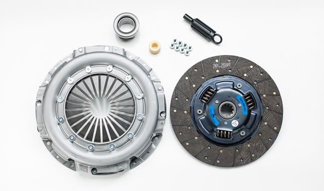

Ok guys, so this was exactly my issue:
And this guy found the issue:
Mine got worse while driving with the camper on it last night, so much so I limped it back home and now I am going to start looking for a new clutch to put in the ol girl. She was getting clunky shifting into 5th gear and I started getting more vibrations from the stick and another vibration noise so I am guessing the clutch or something around it is getting worse.
Now I have to figure out which clutch I want to go with, south bends are expensive, seems overkill for a stock truck, but I do have 5000 lbs sitting in the bed.

I am confused a bit though... Did you replace the clutch or are you still looking for a clutch? The video says you replaced it, but then your writing says you are looking for one.
I had a South Bend 1939OHD installed and it is great for towing 12,000 lbs cross country. The 1944 is the same clutch, but it includes the flywheel. You can see the HD clutch surface/friction area is larger which provides confidence in shifting and starting from a stop with heavy loads. There are plenty of other choices out there that are very well suited to long miles, but I didn't want to chance it with an OEM replacement in a truck that I use for towing heavy cross country 95% of the time.

Yes, gear rollover was 99% gone with the new clutch installed. The combo of the new clutch with the Redline High Temp ATF, I am unable to make the rollover sound even if I try. The clutch is expensive, but I have recommended it to friends on here and each of them have been happy with it. I am confident that this clutch was the right one for me.
Not too grabby and confidence inspiring when towing our 12,000 lbs cross country. Even starting on a steep incline at a stop sign or light, I just put it in L and let up on the clutch pedal and it goes. I must mention that I also have One Up Offroad traction bars.

@sous, just to double check, if I wanted to get the flywheel I would get 1944-60K kit right? I am not sure I would trust anyone around here to resurface the flywheel correctly, figure I might as well replace it all for $700.
