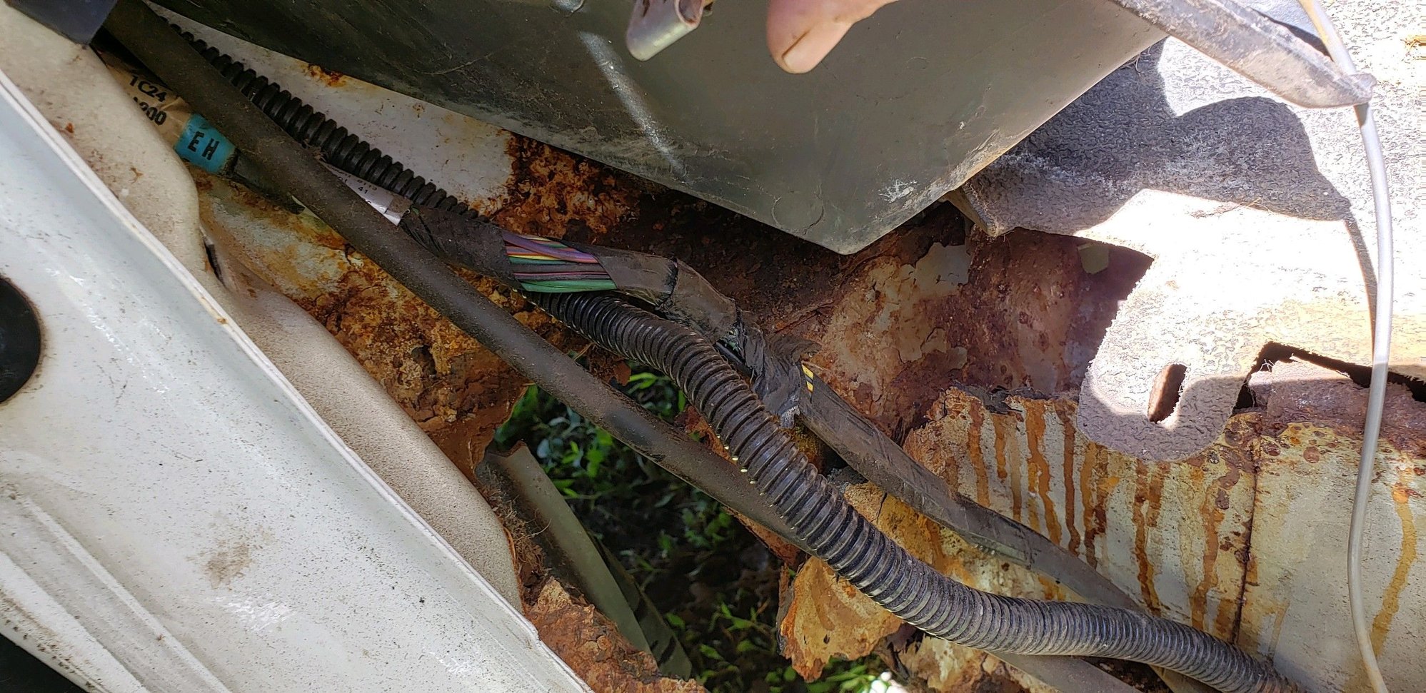

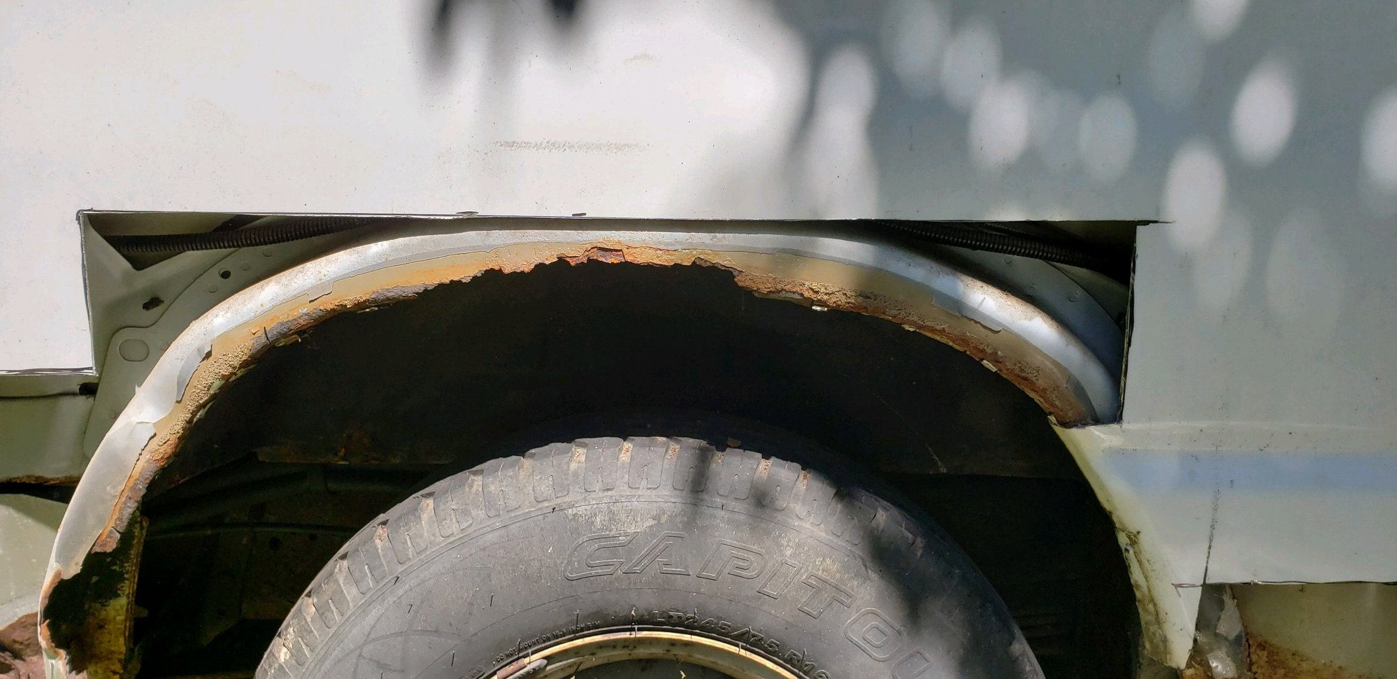

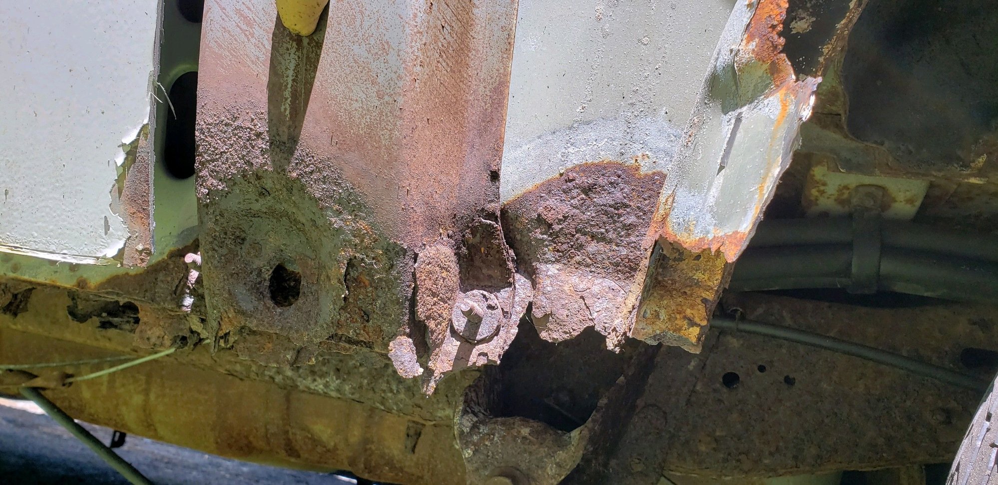

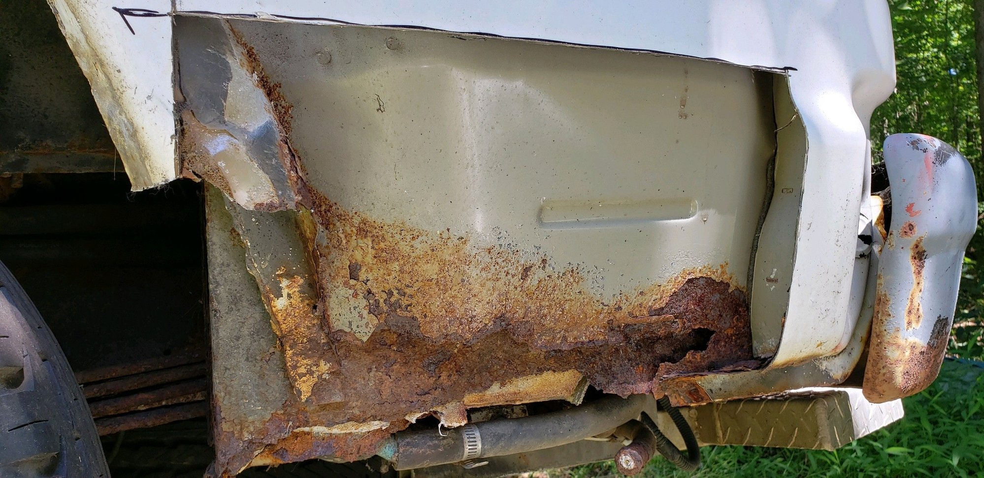

Well my build is taking another turn on this adventure, the quarters and rear lower quarters were exactly as bad as I figured they'd be. But the rocker rust is pretty extensive under the driver's front door, my body man hasn't gotten around to the passenger side yet. Pretty much everything below the floor level of the van in this area is crust. After a brief conversation with my body man we may be doing the first Econoline with boatsides, at least that he or I have seen. Since I'm going with 4x4 and this is going to get used, not as an offroader but old log roads and stuff to get to hunting spots or camping, I think it might be beneficial and since the metal being added will be thicker it should add some ridgity and help slide along in washes and over those hidden rocks and stumps rather than crushing my rockers. It will be kind of Mad Max looking but with a function other than getting rid of rust. It's going to make a big step for anyone else who might drive my van to get in but it won't affect me at all. With custom built bumpers and the monstaliner finish I think what I'm picturing in my mind will look pretty mean when it's all done.
Ouch crusty rusty, changing up plans again.
