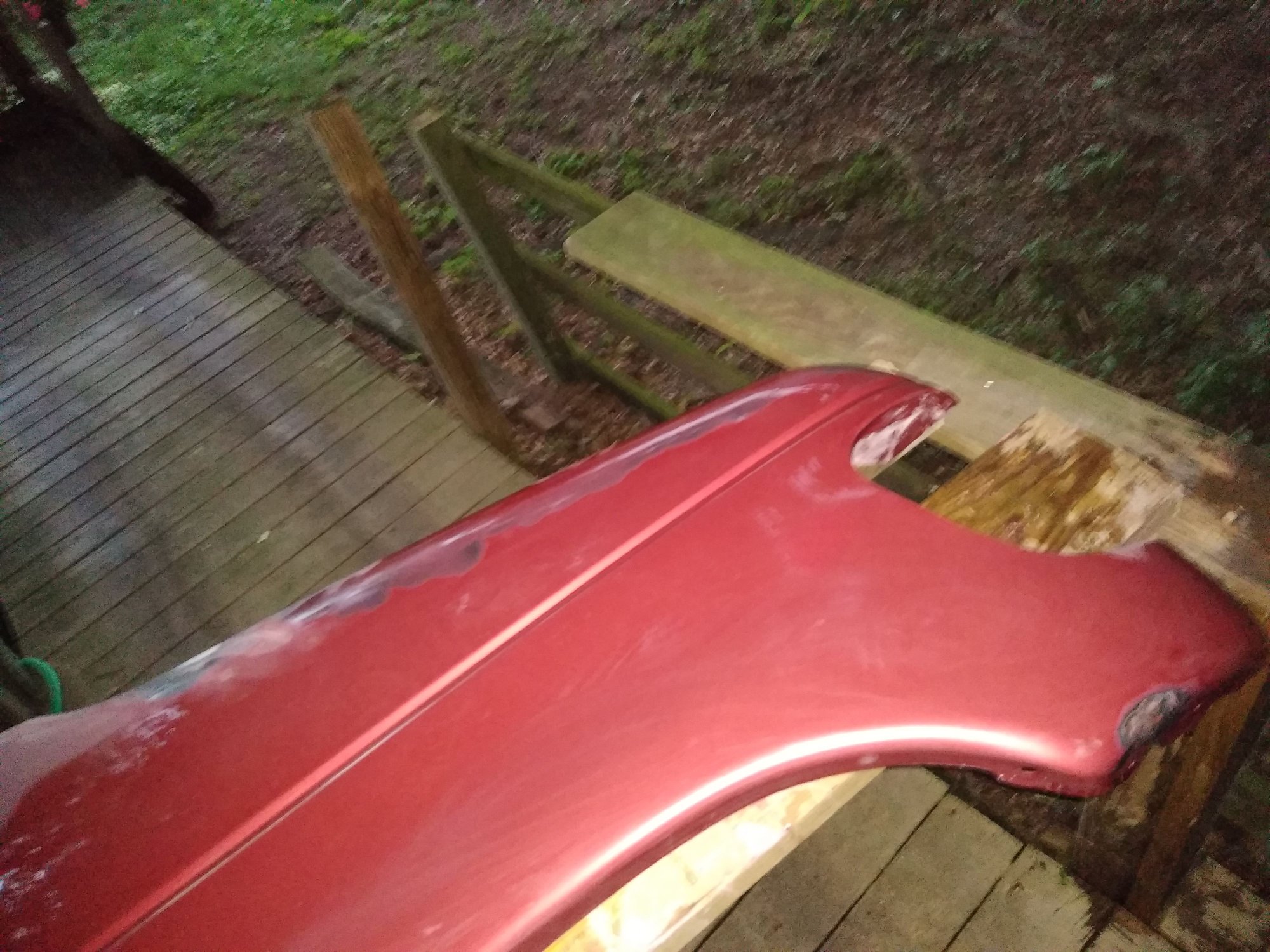

Small ding to fix. It was worse but I did a little hammer work and used a ball peen as a dolly. A very light skin of plastic and noone but the body man, you guys, and myself will ever know it's there.
sanding is not my favorite thing to do but saving money is one of my favorite things. Clear was messed up and had a small ding under the corner light to fix. The price was right and it was local. Body man said sand it with 320 until I can't feel the transition so I did. Hopefully it suits him, I'm no body man but I can spray bomb flat black and camo like a *****. It's getting fleet white to match the rest of the van, hopefully match. I was originally going to monstaline the whole van to help protect the top against limbs and basically give me a finish I don't have to worry about just spray it off and it's good. Lately I've been thinking of using tractor paint and rolling it. I've done off road trucks and mud trucks this way and it turns out tough as nails when it cures, I had to use a grinder to cut it because a wire wheel wouldn't do it, not fast enough for me at least. I might still drop the coin on monstaliner though, at least then there's a reason for a textured rolled on finish other than that I'm a cheapskate. Although a rolled paint job using the tractor paint from tsc is a tough finish. I'm still a ways off from that though. Some guys argue that using a bed liner type finish causes it to rust more. My thoughts are if there's no rust to start with and it's prepped right and applied correctly there shouldn't be rust to worry about whether I use paint or a liner type finish. Any feedback or opinions from someone that knows more than me are welcome. I don't want to do something thinking I'm doing good and really causing harm. Also keep in mind this is not intended to be a show van, it's going to get used, it's going to be squeezed onto trails with growth downed limbs and trees. I just want it straight and solid, and most importantly to be the coolest van in South Central Pennsylvania.
