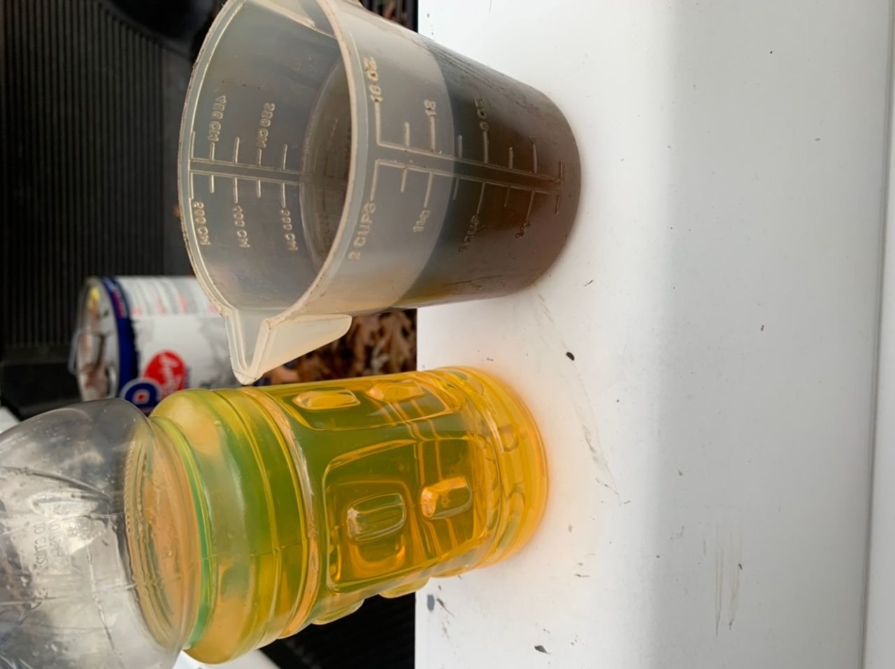

It does look pretty dark. Measuring cup was drained out of the rear tank. Bottle is from the pump. Not sure how much of it could be residual from before I did the injectors. Even when I first pulled the original injectors to do cups the o rings looked fine. I replaced them anyway. Ran them for a while with little to no improvement. Pulled them and inspected them again when I put the new injectors in and they looked good still. Obviously the new injectors had new o rings so I don’t know how that could cause a gallon loss in 400 miles.

It can definitely cause that much loss and more. Ask me how I know. I'd be pulling injectors. That fuel has oil in it big time.

Yeah.. explains my stellar fuel mileage 🤦🏻‍♂️
