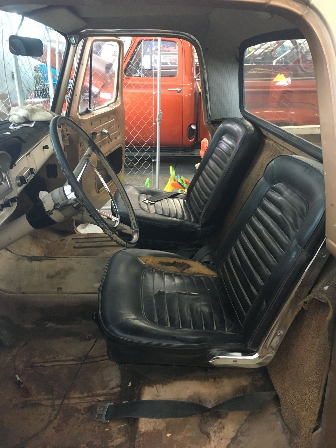

Picked up two 1965 mustang bucket seats in Colfax yesterday. What a snowy mess over there because of drifts.
In regards to color, going with Palamino vinyl interior and Prairie Bronze exterior. Would assume this would have been acceptable combo back in the day and meet warranty plate.

Anybody know source for H81 palomino interior carpets and seat covers?

TMI is a good brand and used by a lot of people. They are not the only ones, but it's one of them. They come with the hard seat back cover, too, but no clips on those so you'd either use some from the old ones or get some new ones. Mustang stuff is all reproduced, luckily.
https://www.tmiproducts.com/mustang/...ket-seats.html
You can select Front only and Coupe and Palomino at that link.
If you want new foams I can say ACI in Shelton, WA has a great reputation.
65-66 STD Mustang ? American Cushion Industries, Inc
SMS Fabrics is one possibility for the carpets. They can send you samples of materials. They could also make the seat covers or source just the material but since the 1965 Mustang standard seat covers are so readily available it doesn't make much sense in my opinion to not just buy the pre-made ones.
https://smsautofabrics.com/
They even make the correct screws for the seat tracks if you need them.
http://www.drakeautomotivegroup.com/...K.aspx?wid=141
Chad

Thanks Chad, I will check out those links on interior carpet and covers. The other fun ones to source will be the correct armrests and zippered door pocket.
Got the seats in to check for fitment and they went in nicely.
The dash pad is black and my hunch is that it's stock. Do you think with the H81 code it should be the palomino color making this black one a replacement?
No.
The padded dash was only available in black, the same one was used 1965/66 on all F100/1100's.
The armrests are the same: 1959 Ford Fairlane/Galaxie, 1960/63 Falcon/Comet, 1961/66 F100/1100, 1963/69 N/NT500/1100, 1967/69 F800/1000.
I think the armrests are reproduced, but only in black, the right side is different than the left side.
The door pockets are reproduced by Bob Drake (located in Grants Pass OR), the moulding that surrounds the pockets are also repro'd by Drake, but are metal. The originals were chromed plastic.
The Mustang bucket seat upholstery (same as Ranger, except with 'running horse' on backrest) has been reproduced for over 40 years and is EZ to find.
The "hockey stick" mouldings on the outside of the seats are also reproduced.
The marks on the firewall and etc body panels were made by inspectors, the letters/numbers identified each one.
