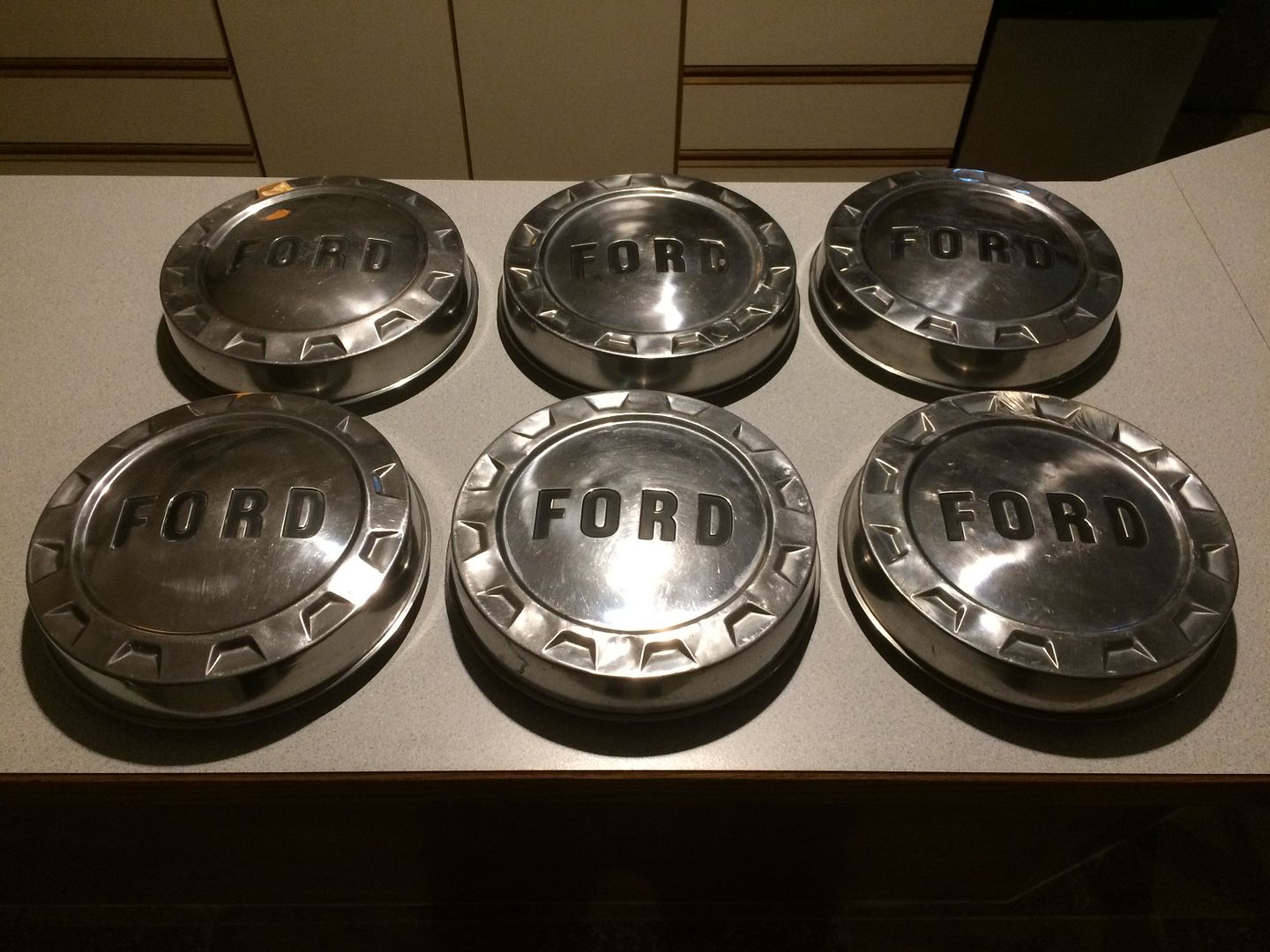

On our rims the FORD script is in black, noticed some sites don't have them colored. Any reason why?

What's your thought on our hubcaps with black script?

I've never seen a painted 'bottlecap' with black letters. My '65 was a Standard Cab, had painted white bottlecaps with red FORD letters. There were also painted argent caps with red letters.
However, a couple days after I bought it, I painted the Wimbledon White wheels black (entire truck was Wimbledon), installed NOS 1952 Packard wheel covers. The bottlecaps 'went to Valhalla.'

I wouldn't necessarily say for 100% sure that a blank color code always meant a non-standard color. I've seen exceptions to every rule I've heard mentioned.
Stainless caps having black letters is very common amongst the used stainless caps and the literature I've seen. Here's the 6 F250 size caps that I've gotten from two different sources.
