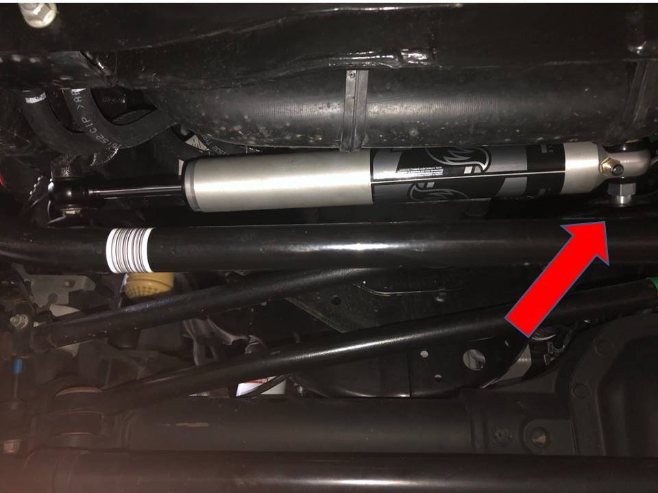

Does anyone have the torque spec for the tapered bolt that attaches to the stabilizer arm?
I have the FOX 985-24-001 single stabilizer on my 2019 F350. Wanted to make sure it was torqued enough, looked all over and all i could find was the spec for the shock attachment nuts.

The Torque spec I'm looking for is indicated by the red arrow, the tapered bolt, the end that mounts to the drag link.
I did 60 # ..that's what I was told for that end

Thanks. I did 67# initially, just wanted to verify what everyone else was using.

My torque specs above are from the factory service manual.
