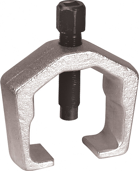

Can u give me some more info on the puller u used? Cuz I bought one from harbor freight . Not sure if it was big enough cuz it snapped the puller into bits when I used it
Sure thing. Mine is very similar to this

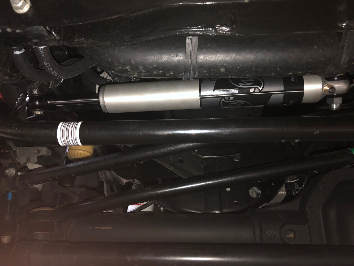

Size:  723.1 KB this is it installed

Originally Posted by dave91gt
Attachment 263004 this is it installed
Cool thks.. Are you running stock tires n suspension?
