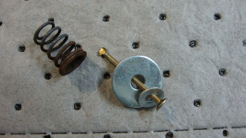

Inspect rear E brakes, in particular, the shoe retainer pins. They pull through the backing plate and grind up everything.
Look at the shock bolts. I had a loose shock and it kathunked.
Mine had 60K on it and the Ebrakes pins pulled through the backers. I caught it quick enough to band-aid it with drum brake pins, retaining springs and fender washers then regularly pack the cavity on the outside of the backing plate with grease. This will get it by until I go in to R&R the carrier bearings at 85K due to the inept stealership mechanic who replaced the pinion seal at 40K. They didnt install a new crush sleeve. Every time I let someone else touch this truck.....GAH
