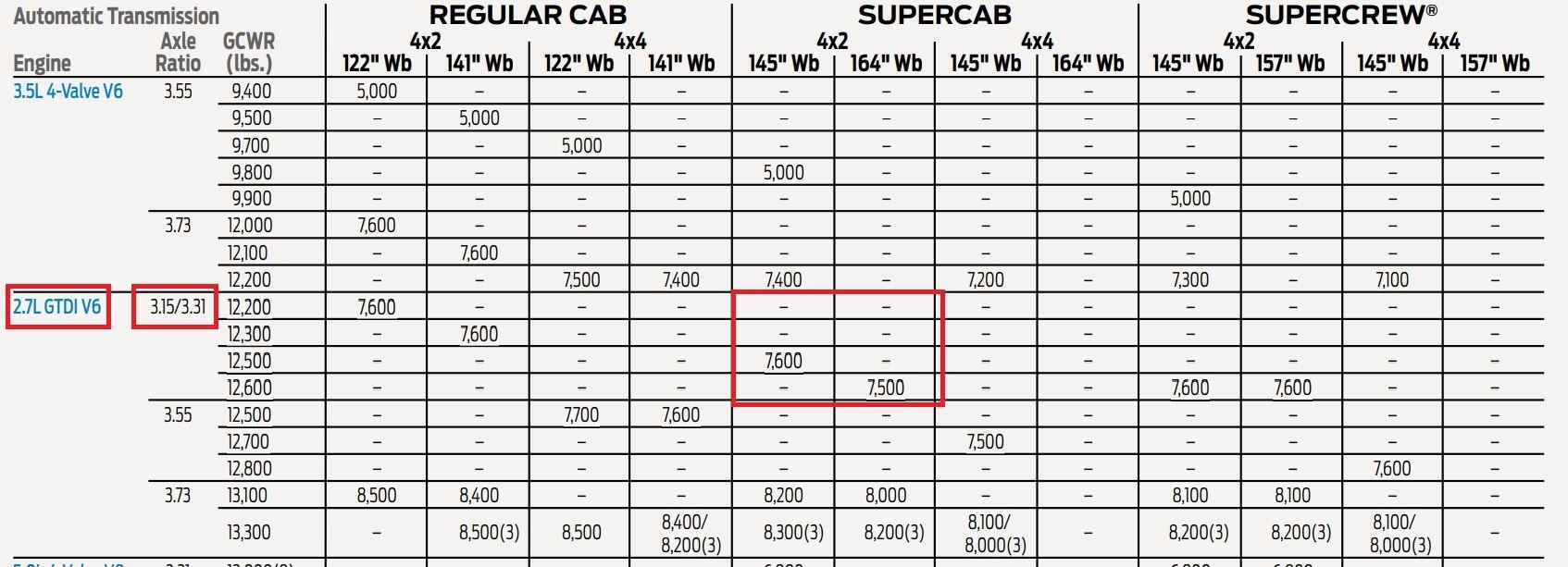

Are you looking for a max trailer weight? Unsure of your wheelbase - but you're looking at either 7500 or 7600 lbs conventional towing with that setup (see below)
As with every other 1/2 ton, you will most likely run into a payload limit before towing limit. Check the door jam sticker for payload. That is the max that you can carry in cab, bed AND trailer tongue weight.
As you mentioned, the 2.7 w/ 3.15s isn't the most potent towing setup available - though you might gain some payload being a 4x2

Do you have the class IV hitch? You can add the Trans cooler and bigger front sway bar.
look at the trailer tow guide and it will tell you what you need.
https://www.fleet.ford.com/towing-guides/
