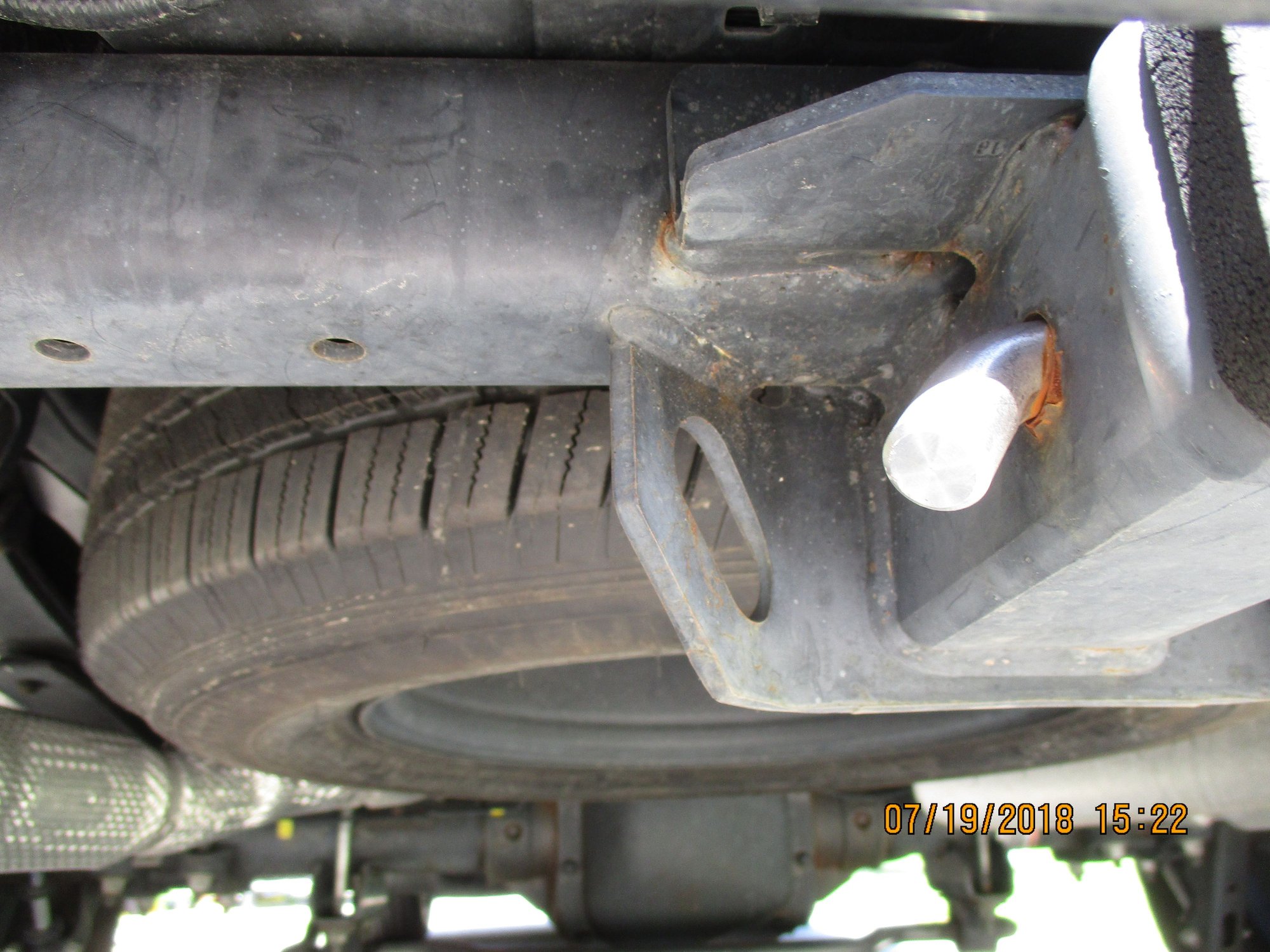

Is there a visual cue on the reinforced bumper?
Old Jul 19, 2018 | 02:30 PM
Tow Matr's Avatar
Tow Matr
Joined: May 2016
Posts: 74
Sorry, don't have pics of other brackets, but this is a max tow bracket. Someone awhile back on the other forum changed the bumpers/hitches out and the only difference he could find is where the safety chains attach. I would like a Raptor bumper/hitch for the welded on tow hooks (to go with my Raptor bumper) but don't want to lower my tow ratings.
