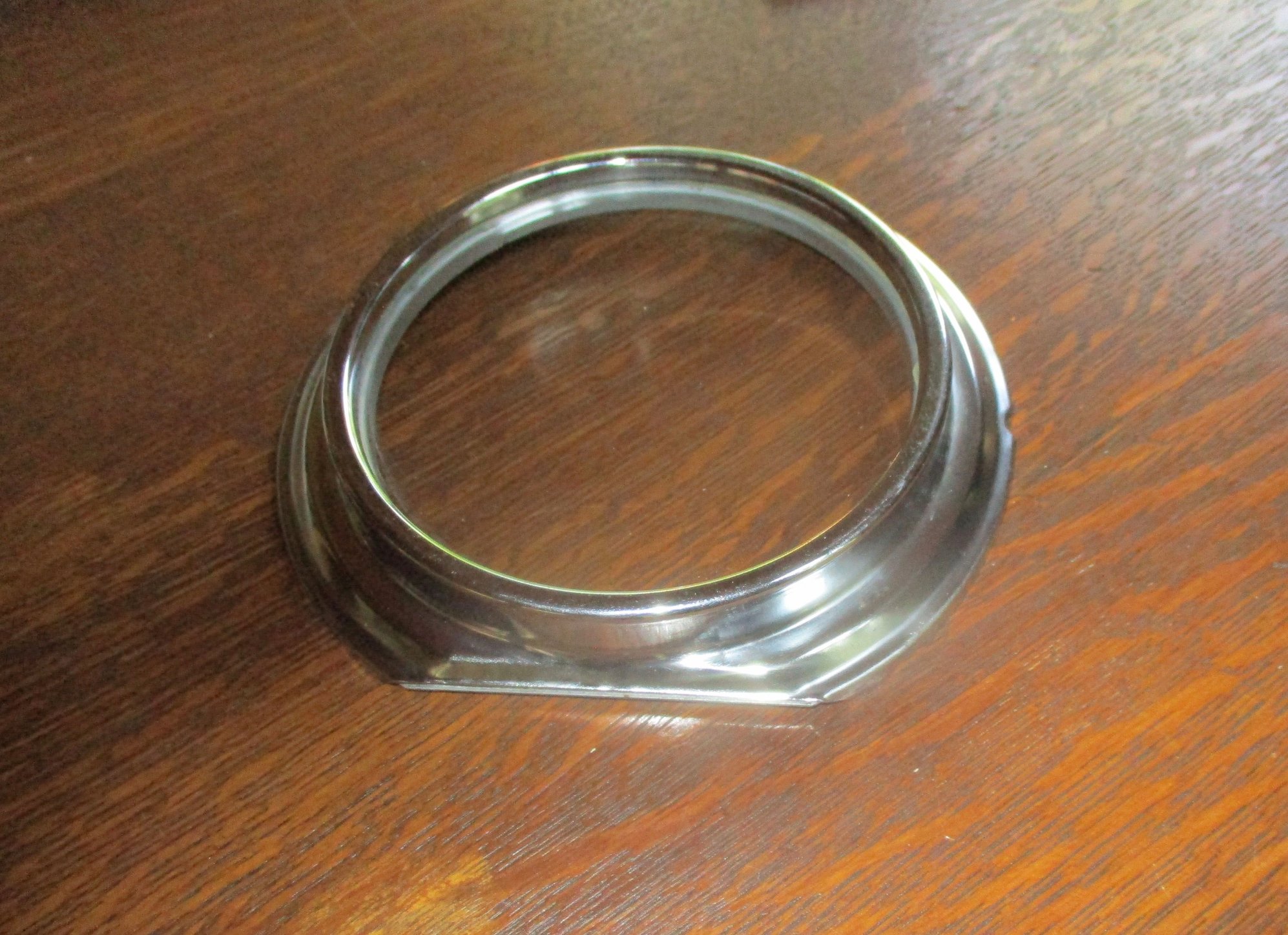

My gauges are all still sort of working. The temp gauge never makes it all the way to hot, but then I haven't been going up any mountains in 2nd gear either. I think though that I'm ready for Pennsylvania.
One of our long time members, and acknowledged experts, noticed that my speedometer bezel was looking a little tired and worn:
On his own, he offered to send me a replacement. For payment, all he asked for was the cost of postage. This is what arrived:
...And this is what it looks like installed:
Isn't that a great story? Someone I've never met, took it upon himself to help out with my project. It just goes to show what a great place FTE is for help and support.
Jim
