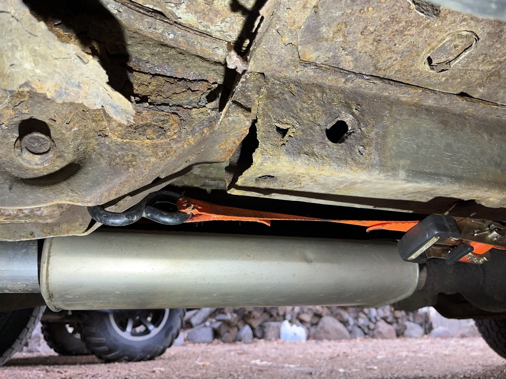

Hi Ray. I met with the frame guy yesterday and did some crawling around under the jeep with him. The frame is kind of a hybrid. It has some frame-like structure to it, but it is tied into the body structure like a unibody. The guy thought for $1,000 he could fix it, but did somewhat question if fixing it would be the best decision. When I mentioned what the scrap yard was paying, and I was leaning in the direction of parting with my Jeep, he said a friend his might be willing to pay the scrap price for it, and have him (the frame guy) fix it. This solution appealed to me. The potential buyer wants to see the Jeep first though before committing to the deal.
As far as spare parts go, there may be some, but the vehicle has close to 200,000 miles on it.
Here's a pic:
It doesn't appear to have any rust, but crawling around underneath, there's a lot that is hidden from view. The rocker panels for instance are all but eaten away, but you don't see it because they are covered with plastic cladding that will one day (maybe soon) fall off. I don't think I've ever taken a vehicle to the junk yard. When I'm finished with them, I've always managed to give them away to someone who needs them more than I do--in the case of this jeep--I may get little money back in the bargain (hopefully).

My 2004 Jeep, with the broken frame that's destined for the junk yard, made it home today. The 15 mile trip came off without incident largely thanks to a little help from a ratchet strap. I wanted it home again to get some parts off of it for the newly purchased 1999.

A rachet strap holding the frame together? Awesome
It doesn't get more American ingenuity than that. Now I'm thinking you should keep it for a couple more years.

I know. The strap worked great. One hook was on the trailing arm bracket, and the other hook fit in a hole in the frame about 4 feet forward. It was almost like the hole was there for just such an emergency. The ratchet pulled the two pieces of the frame together, and the floor provided the structural support needed. I thought I may have to crawl along at about 10 mph, and even at that, maybe not make it. Instead I went 35-40 mph, and everything held together just fine.
I've driven a lot of miles, but I've never had a frame fail like this. Does anyone think undercoating is a good idea? I had a 68 Plymouth "Ziebarted" in the early 70's, but it rusted pretty bad anyway.
Jim
P.S. Look at that beautiful muffler. I just had that put on a couple od weeks ago.

Undercoating only helps if you get it on when the car is brand new, before the elements get to it. Active rust will grow in the absence of air, so if you coat the rust, it will keep rusting. Even then, it may only slow the process down a few years. In your harsh salt world, I wouldn't count on anything being a cure-all. Drive-em till they drop, just like you did. That's similar to what my dentist said about my failing crowns. "You can use them until you can't." So far, that's been my plan.
