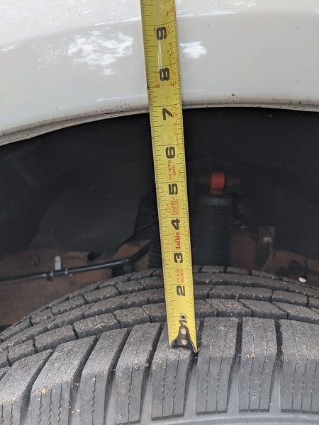

Minor update. After more than a year of use there has been a bit of settling at the front springs resulting in an unattractive amount of rake and a bit of tire rub.
So I swapped out the stock rear shackle of the front leaf springs for some after market units about 1.5" longer.
Resulting an about an inch of lift in the front. Looks better and almost no rub.
Still lovin it!
CR

Are those stock springs or something else?
