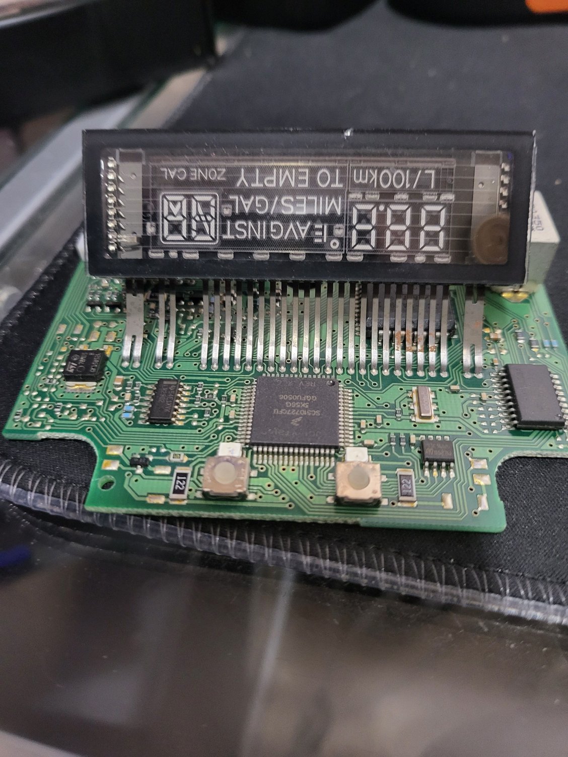

Hello Everyone, I had an issue with the Compass not displaying on the overhead Console. I found the issue on the circuit board.
This element needs to be resoldered on the board and all is well. I didn't have a solering iron with me so i used a hot glue gun.

Things keep "de soldering" and breaking loose in this module. I had to replace and re-solder several components.
I am thinking on enclosing it all in epoxy.
I am afraid that hot glue will fail very fast there. Mind that if solder itself fails, hot glue has no chance. You should re-solder.
Yes I will resolder but I didn't have a iron handy at the time. Thanks for the response my brother.
