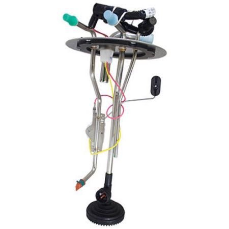

This is what the fuel sender/pickup/return looks like.
The pickup foot has a side valve to it for an icing condition, where heavier then the fuel water resides at the bottom of the tank, freezes, then blocks the screen pickup. The icing side valve opens under excessive suction and allows fuel to be drawn in above the ice dam. When the valves fail, nd they do, a low fuel level draws in air, lowering fuel pressure.
To the left of the foot is the return line along with a “duckbill” valve, something I have never fully understood in purpose, but manufacturers don’t spend a penny on installing something without cause. If the system is drawing in air and you have a 1/3 tank or more of fuel the air will bubble through the fuel and you can have that particular sound. However if fuel is air free and just low in the tank you can hear the returning fuel splashing into the lower level of fuel, similar to what we hear every morning after we waken and hit the head. Hey, I’m looking for the easiest reference.

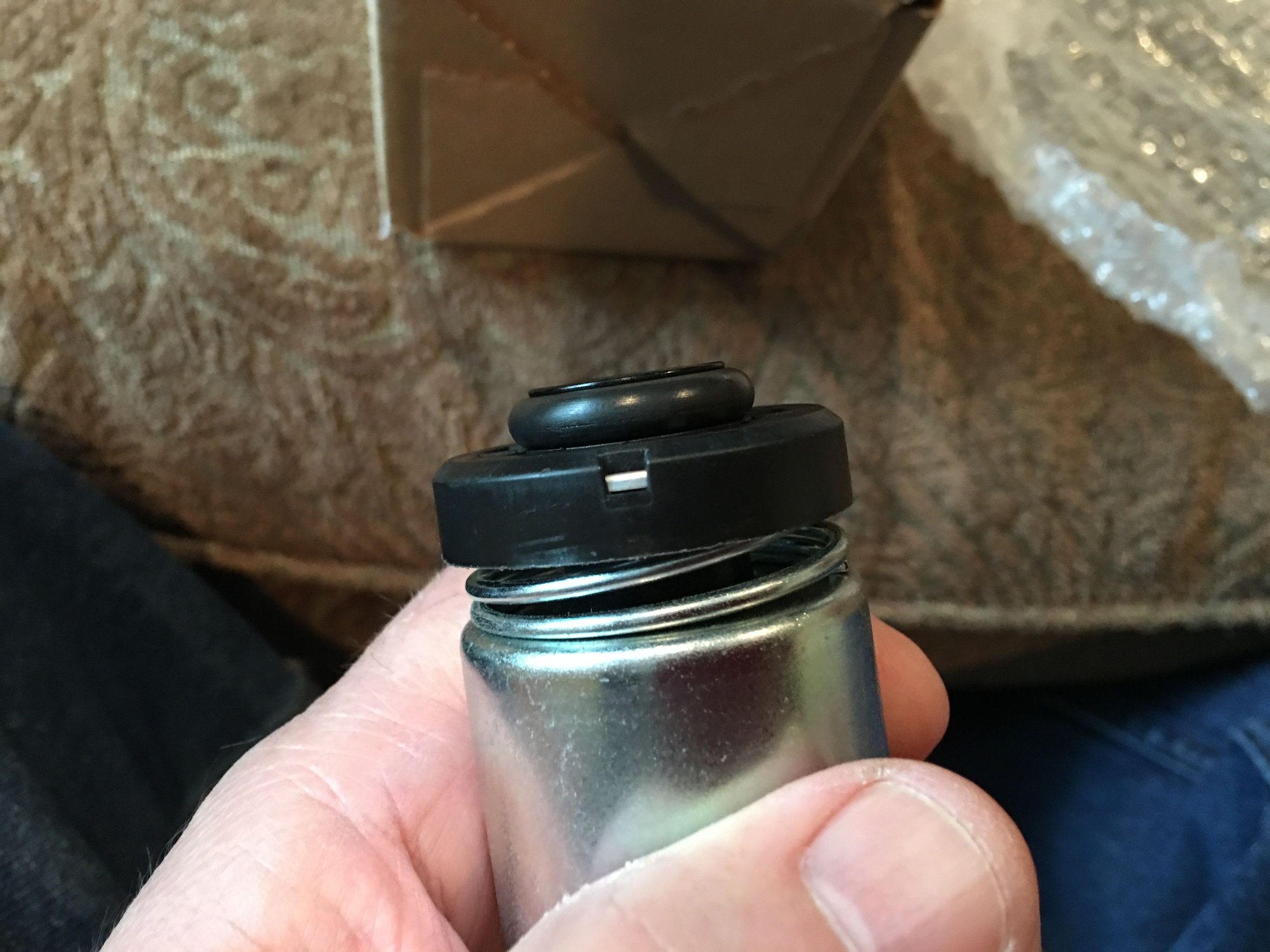

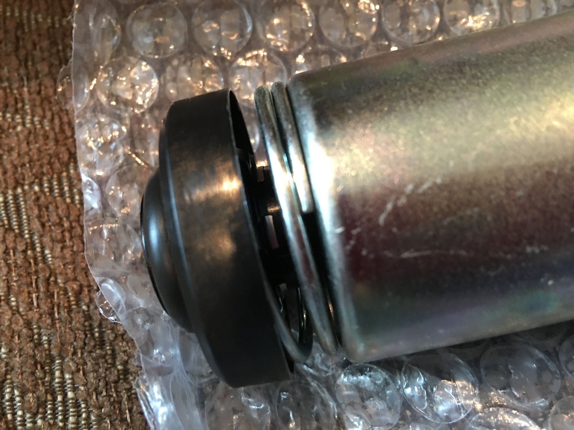

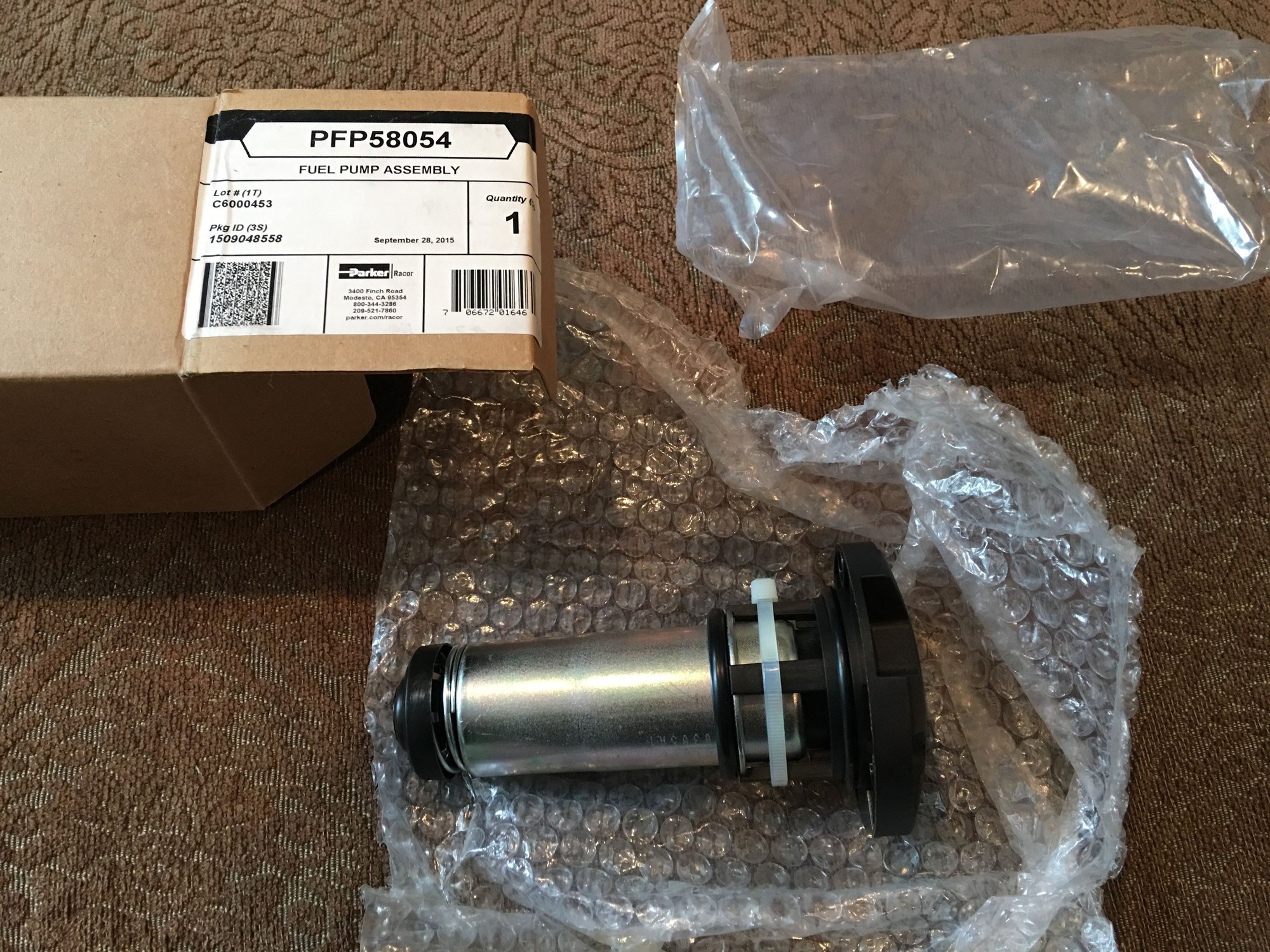

Here are some pictures from the Racor pump I have on the shelf.
There is an installation video from Airtex on this pump, but it's a simple swap so maybe I'm just swinging in the air.
Three different O-Rings that need to be lubed before going in, the end one on a piston that is spring loaded. So the housing needs to be cleaned to get the last one to seat, and I would check them all to make sure they have good integrity. If they are OK I think you have to confirm with another pump. Salvage yard ones typically sell for under $100, often like $75.
I'm an R&D guy, but despite a few hundred thousand dollars of test equipment in the facility, it all comes down to trial and error. I don't know how else to check this, unless someone else has an idea.

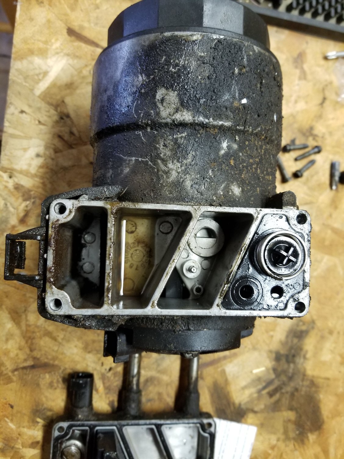

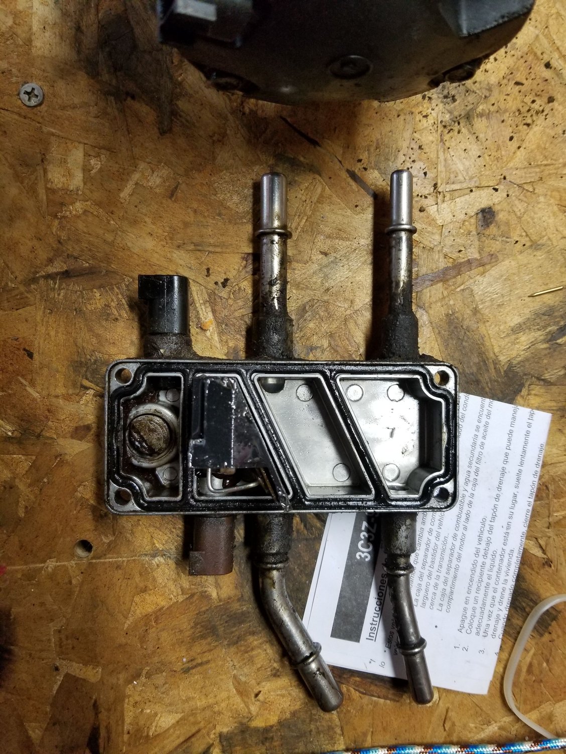

Can anyone provide a diagram as to how the HFCU is put together? I want to make sure my brother in law put it together correctly last night.
Old May 27, 2018 | 03:12 PM
  #84
FiznUKa's Avatar
FiznUKa
Joined: Mar 2014
Posts: 1,468
From: Salt Lake City, utah
https://www.ford-trucks.com/forums/1...l#post17935639
ill look and see if I have more pics
