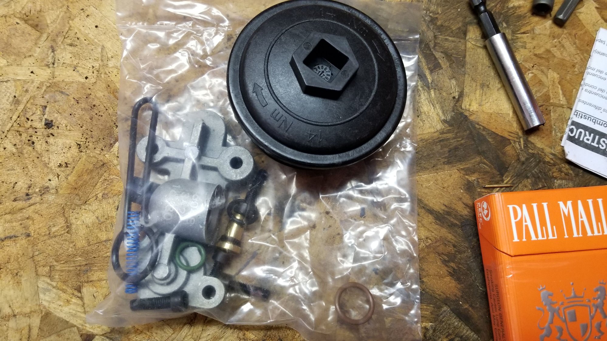

I can't say for sure what was wrong with the install, I can now hear air and fuel moving (gurgling) through the lines. Sadly, I just broke my fp gauge adapter so I will need another one to give good readings. This project has been one thing after another. Right now I have the regulator apart. So far everything looks good. I have a kit on order in case.

Mine looks to be upgraded already (spring isn't blue but long skinny and still stiff) The gaskets and o ringsare in good shape. I went ahead and put it back together, I don't have a lot of fuel coming out of the test port. I have some but not flowing out. If I take the filter cap off again I'll have to replace it. The "nut" is more rounded. Seems like nothing going right here.

Replaced fuel pressure spring and fuel filter cap. Have fuel back at the bowl, can't check pressure until I replace the adapter.
I'm back to my original problem, cranking no start.
