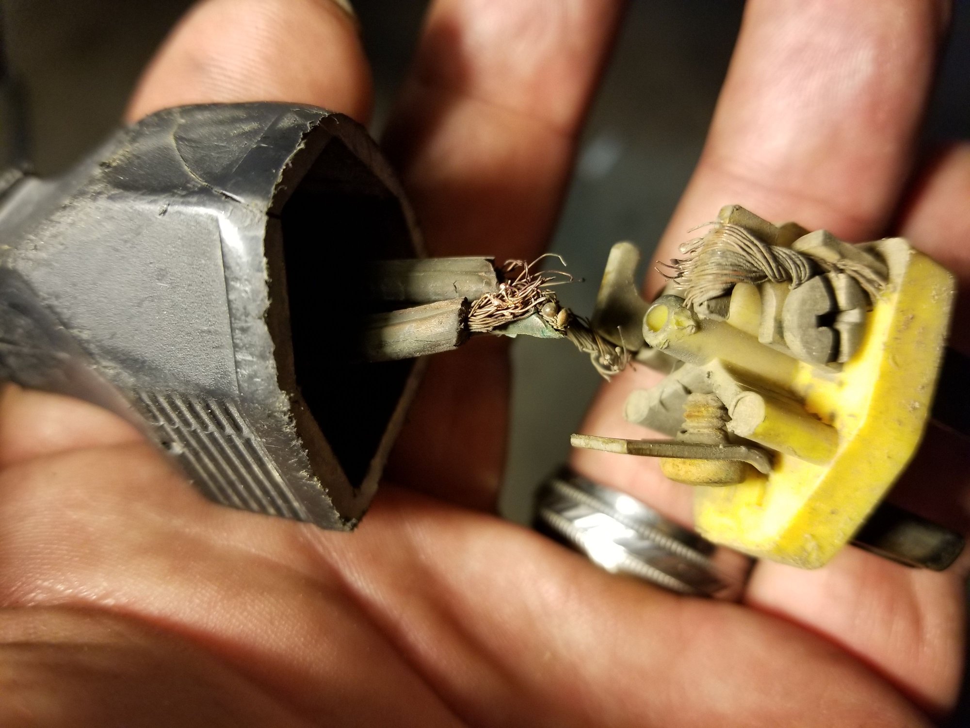

Originally Posted by COVeteran
TMT, that's without the block heater. I haven't fixed the wire yet.
I'd say there's a problem. Holy cow!

Got the plug all cleaned up and back together. Truck is plugged in for now. I can't get another pressure gauge adapter right now. I took Mark's advice and reached out to the Colorado Chapter here the other day, but had no response.
