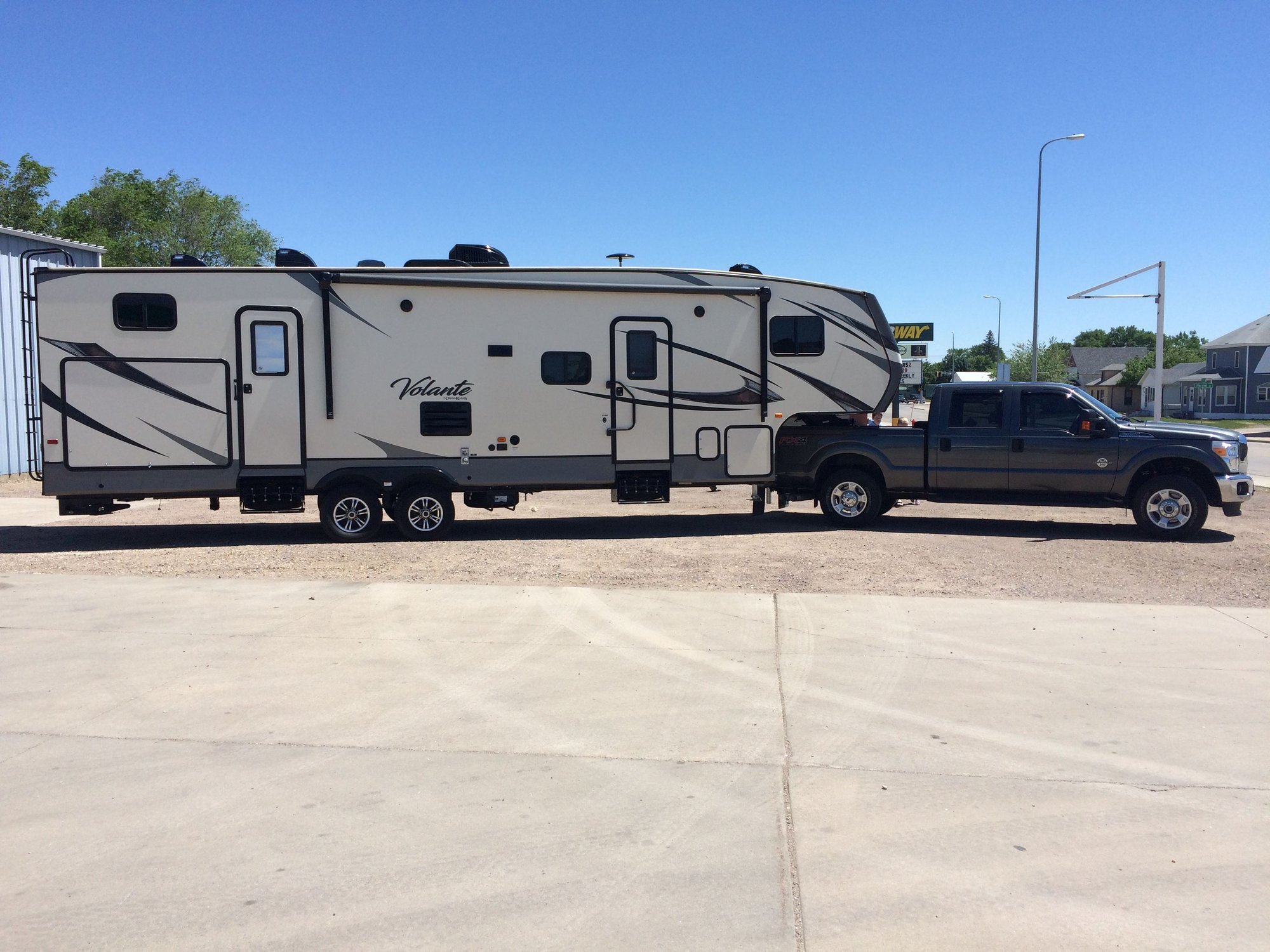

Got it installed. Much better breathing room between the trailer and endgate when hooking up.
Can make a full 90 turn now.
I couldn’t tell any difference in towing vs the old way.
