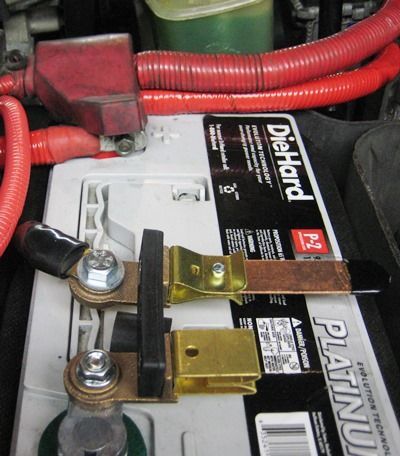

Ahhh Mark's comments about the need to remove the negative leads when working on the truck reminded me of a good reason why lead battery cable clamp terminals are disliked in favor of the newer style, especially when comparing the number of tightening / loosening cycles each type of terminal can withstand over a lifetime. I wasn't thinking about lead deformation issues, because I've always had some version of tool-less quick disconnect on my batteries, so that I have no excuse to disconnect them.

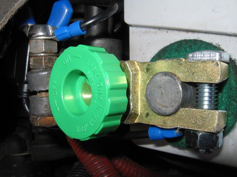

Prior to installing the higher amperage rated knife switches (to both batteries) as shown in the photo above, I used to have the round **** type disconnects as shown in the photo below (which I do not recommend for diesel trucks with high amp loads)
The knife switch is rated for two and a half times the amp load over the **** switch....
It takes longer to open the hood than it does to disconnect the batteries with these knife switches. And thus this is probably another reason my original battery cables are still intact... they are never stressed with reinstallation cycles.

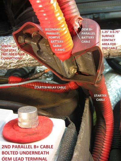

I suppose another reason I'm hanging on to the original style cable lug is because I took advantage of the huge hunk of lead on the OEM positive lead on the passenger side battery, by drilling and tapping the meaty section for additional wire leads (that never get removed on and off, since only the negative leads need be switched off to disconnect batteries).
With the current batteries installed working on their 10th year in service, my battery cable lugs generally sit undisturbed for a very long time. I can see where more active installation cycles on battery leads would lead one to look for alternatives.

That's a frightening photo!

Those round green **** type cutoff switches aren't good for anything. Cheap cheap
