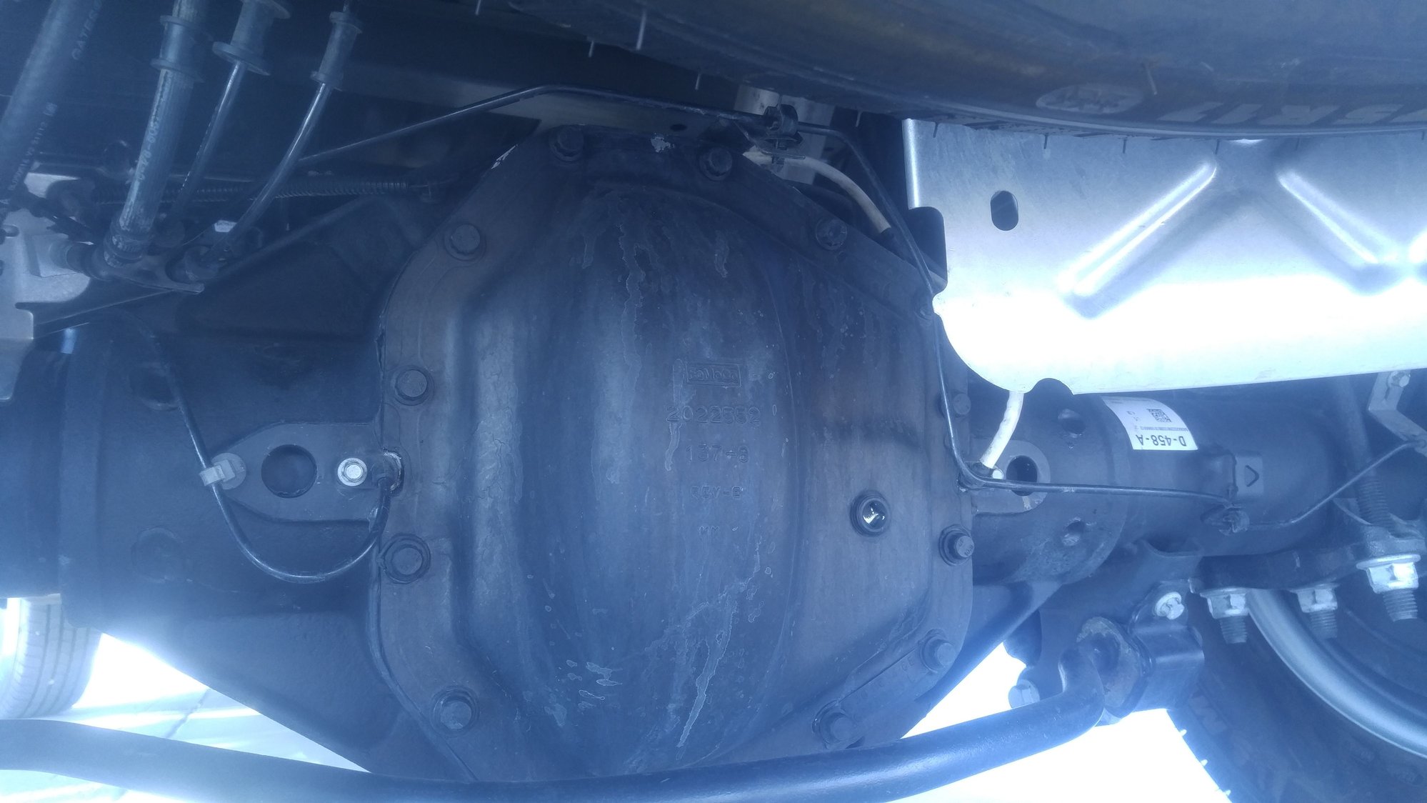

Originally Posted by willynilly
what has the dealer done to try and diagnose the problem ? wheres the breather nipple located ?
Checked gear oil level, temperature, pulled cover, inspected for wear, checked flow rate of drain tube.
The vent bung is on the driver side tube, on the top.
either way, i think you have better chance of winning lotto than getting new axle assembly

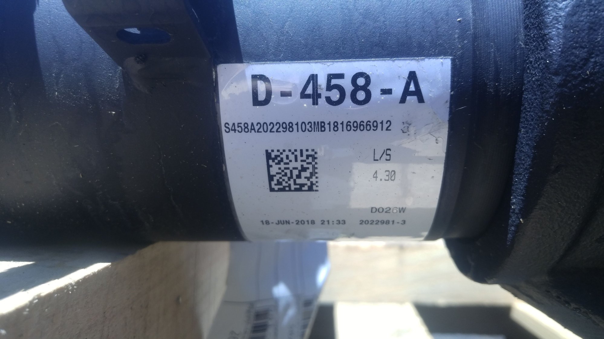

After months of dealing with a weeping vent bung Ford finally shipped an entire replacement axle. Hopefully this issue will be put to bed once and for all.
Bom sticker.
Seeing this axle out if the truck makes it easy to see how beefy it is. Makes a dana 80 look like a toy.
