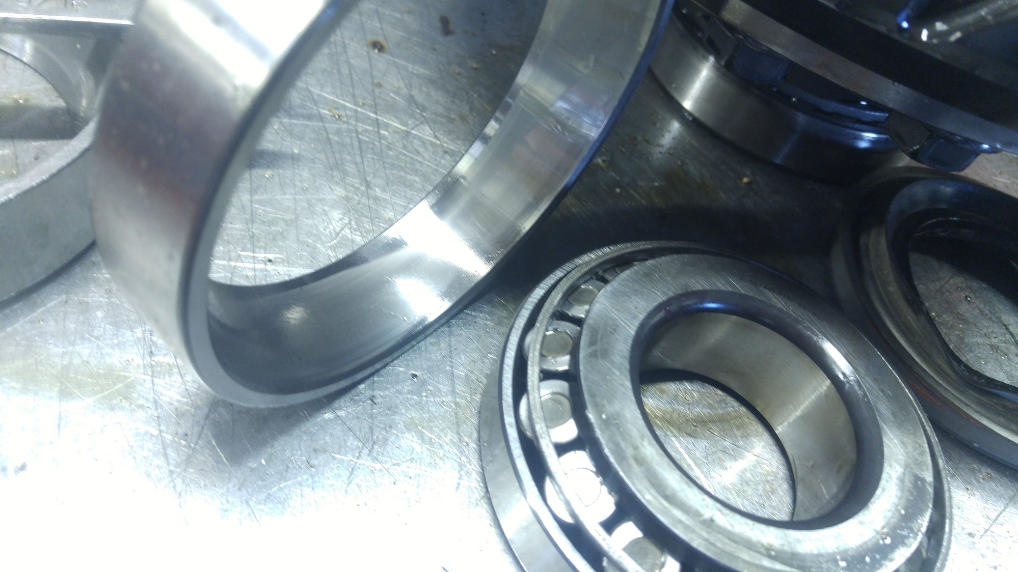

Welp had an issue with gear noise on the new truck. Took it into dealer and snapped some pics. Axle is the Dana M300. Will report on the results soon.
Tech said carrier literally fell out of housing indicating little to no preload. Evidence shows skewed bearing roller path on both carrier bearing races.
Pinion had too much preload. Rollers had some scars and uneven wear patterns.

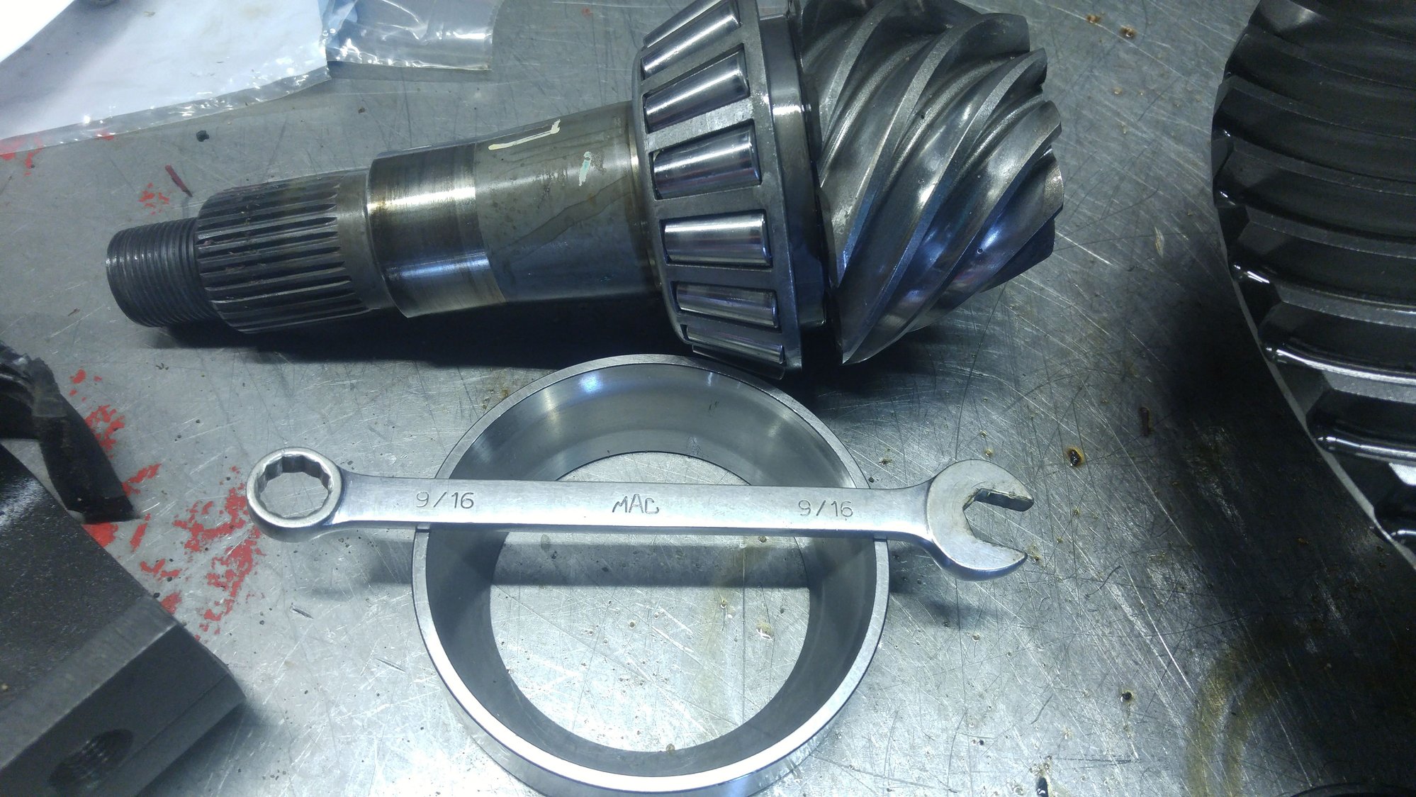

Here's all the guts on the bench. Gears looked good.

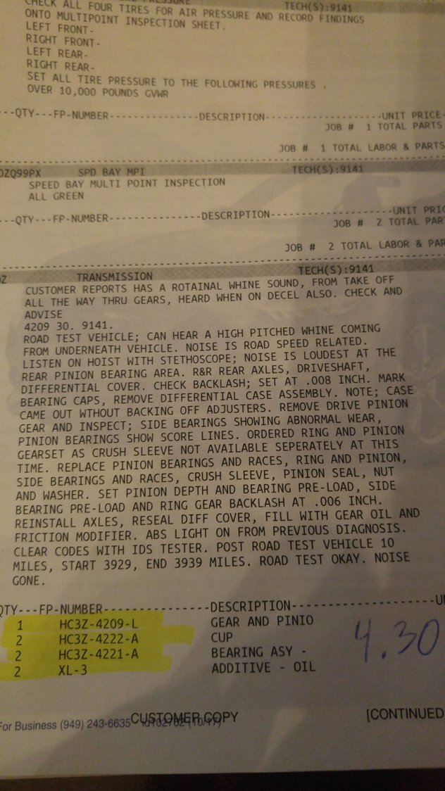

Here's the service record. The backlash wasn't too bad. Part numbers are below but the gear set is for 4.30 ratio.

Yes, .008 backlash isn’t all that bad but no case preload is. That’s great that you got all new parts! Sounds like they fixed it. Did you notice a big difference in noise?

I believe that’s the first time I’ve ever seen a picture on any M300 internals. Parts look pretty stout. I don’t think there is a strength issue with these rear diffs! Was your a factory limited slip? If so, did it have coil type preload springs on the clutch packs?
Yes, Limited slip, it does use the typical clutch pack. I believe the springs are wave design, not coil.
