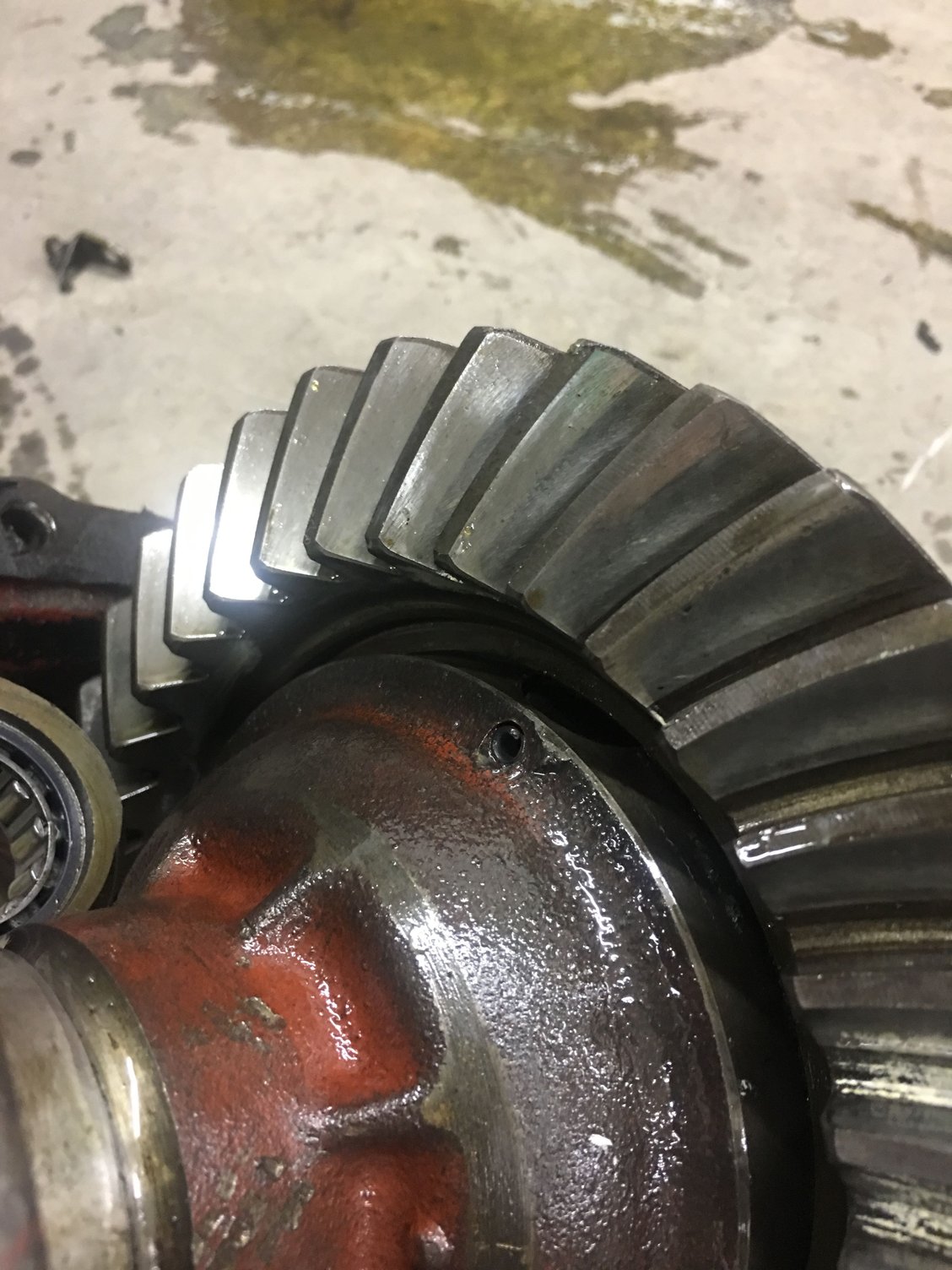

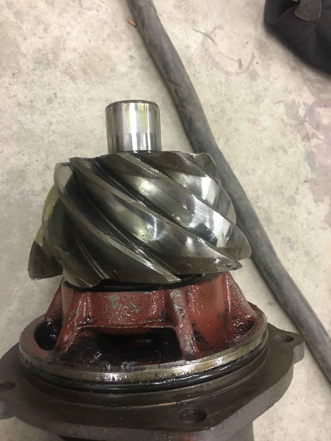

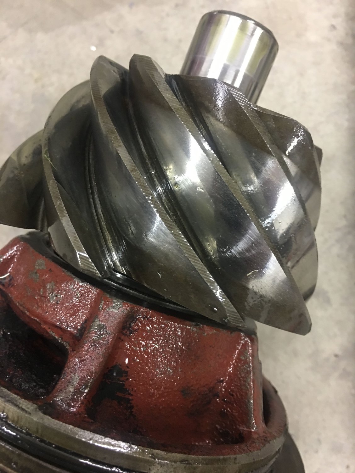

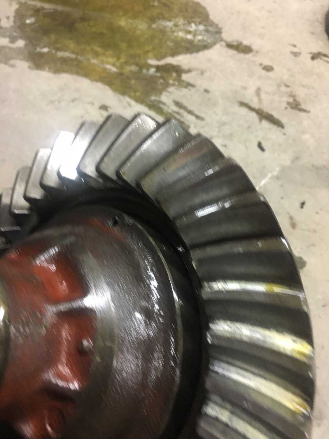

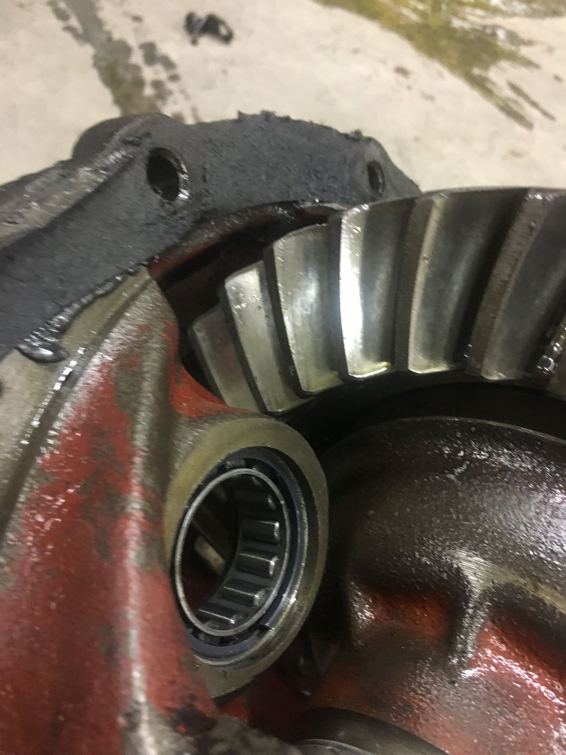

Don’t know if these are good enough pics.

Your ring gear to pinion clearance is too tight. Look how deep the pinion is in the ring gear. That means the wrong shims were used. The R&P look reusable but the bearings should be replaced and it needs to be rebuilt to proper clearance.
