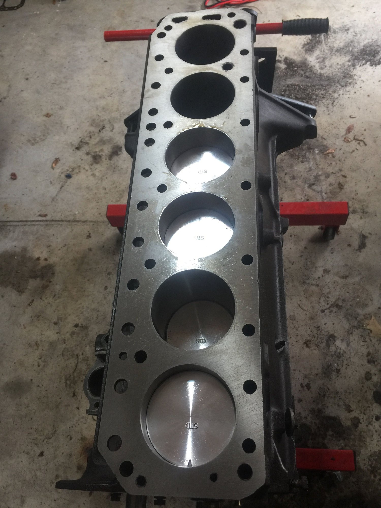

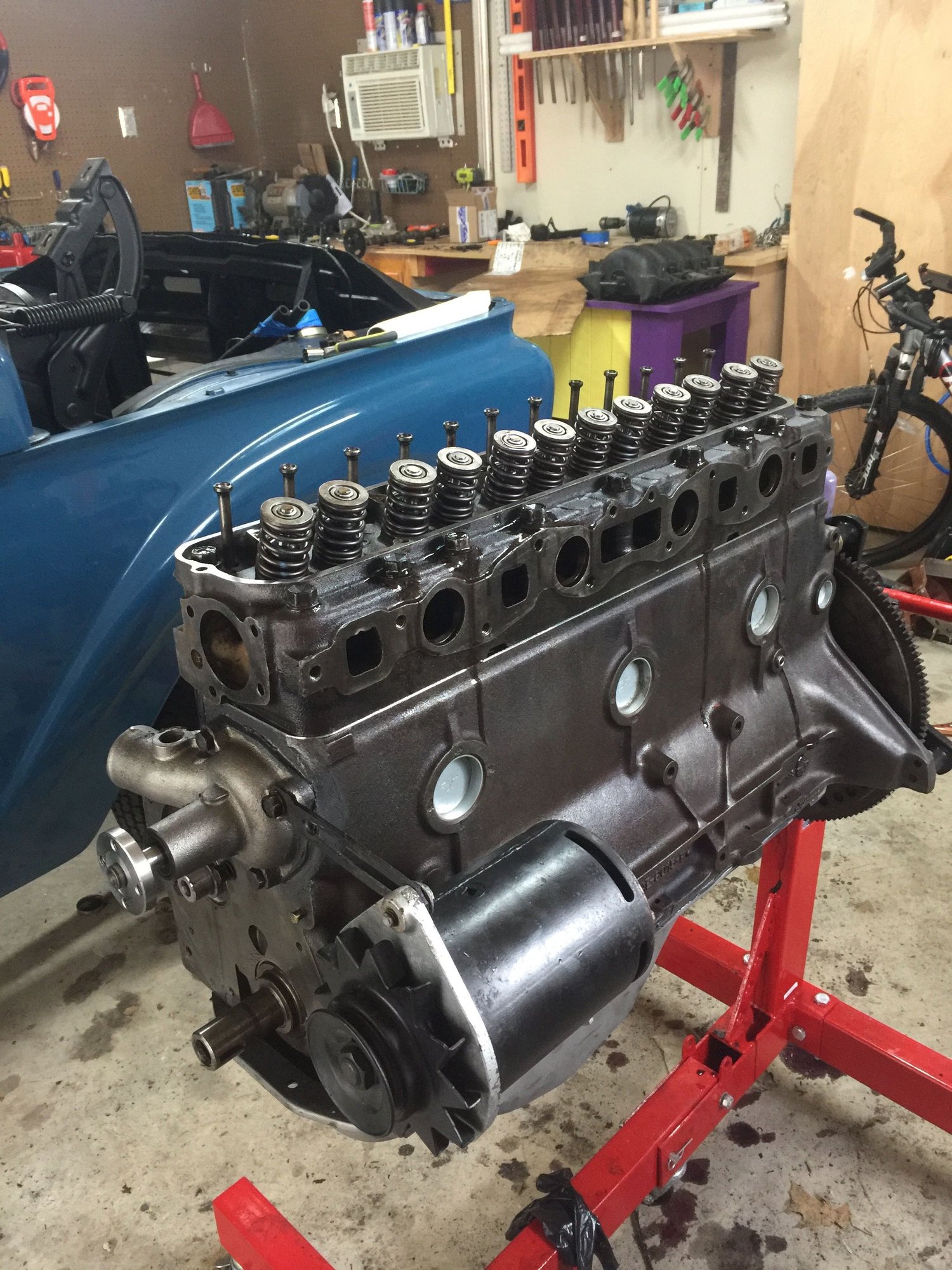

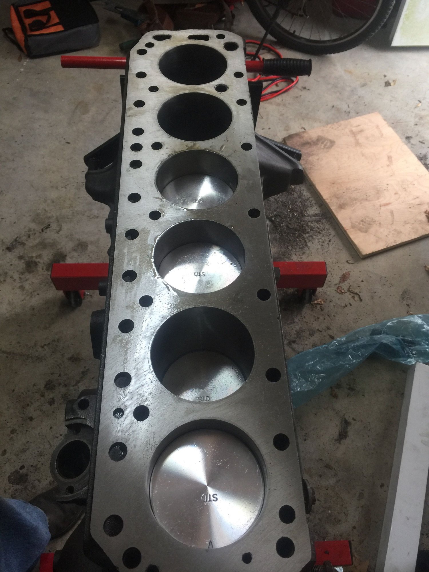

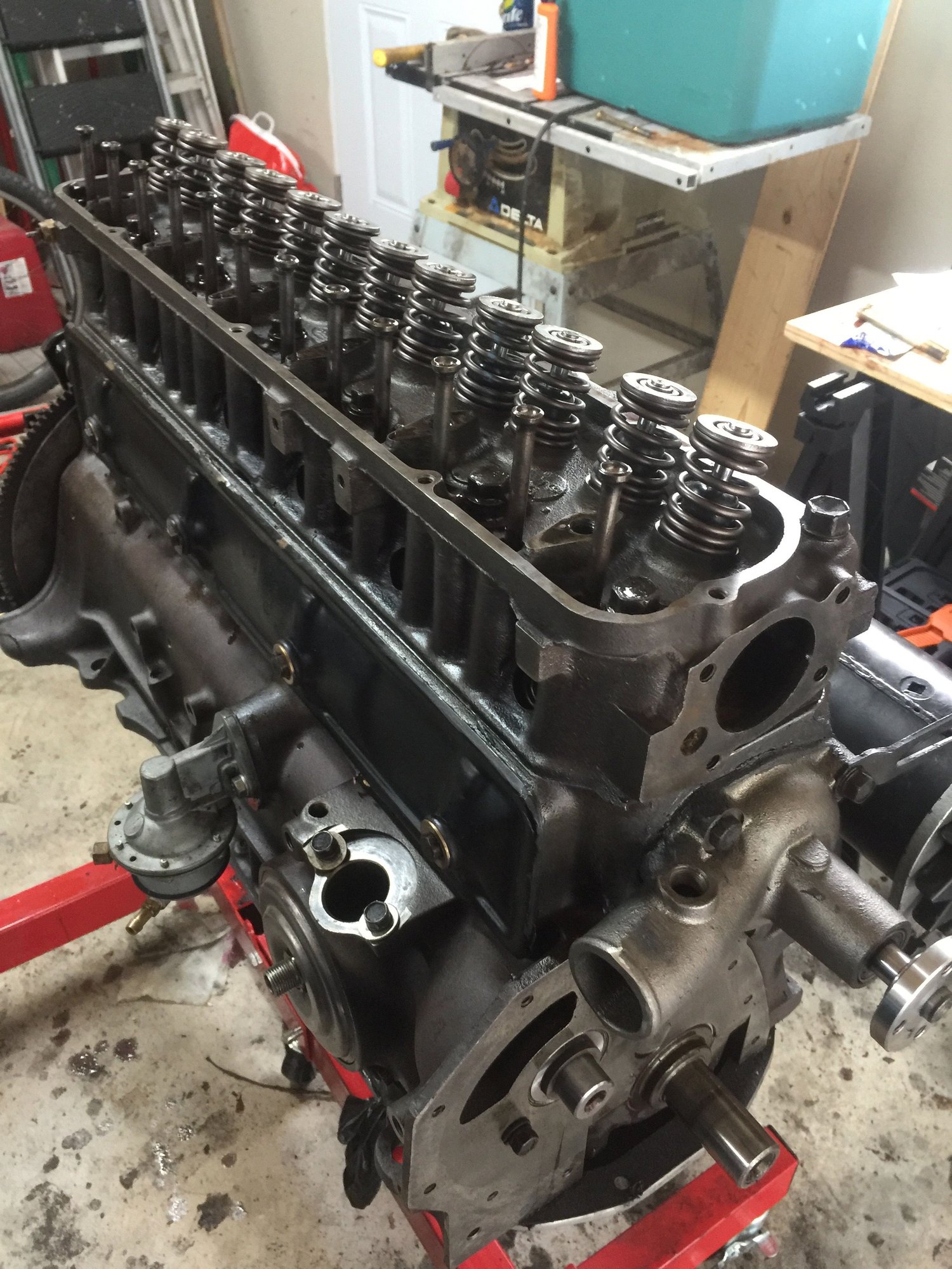

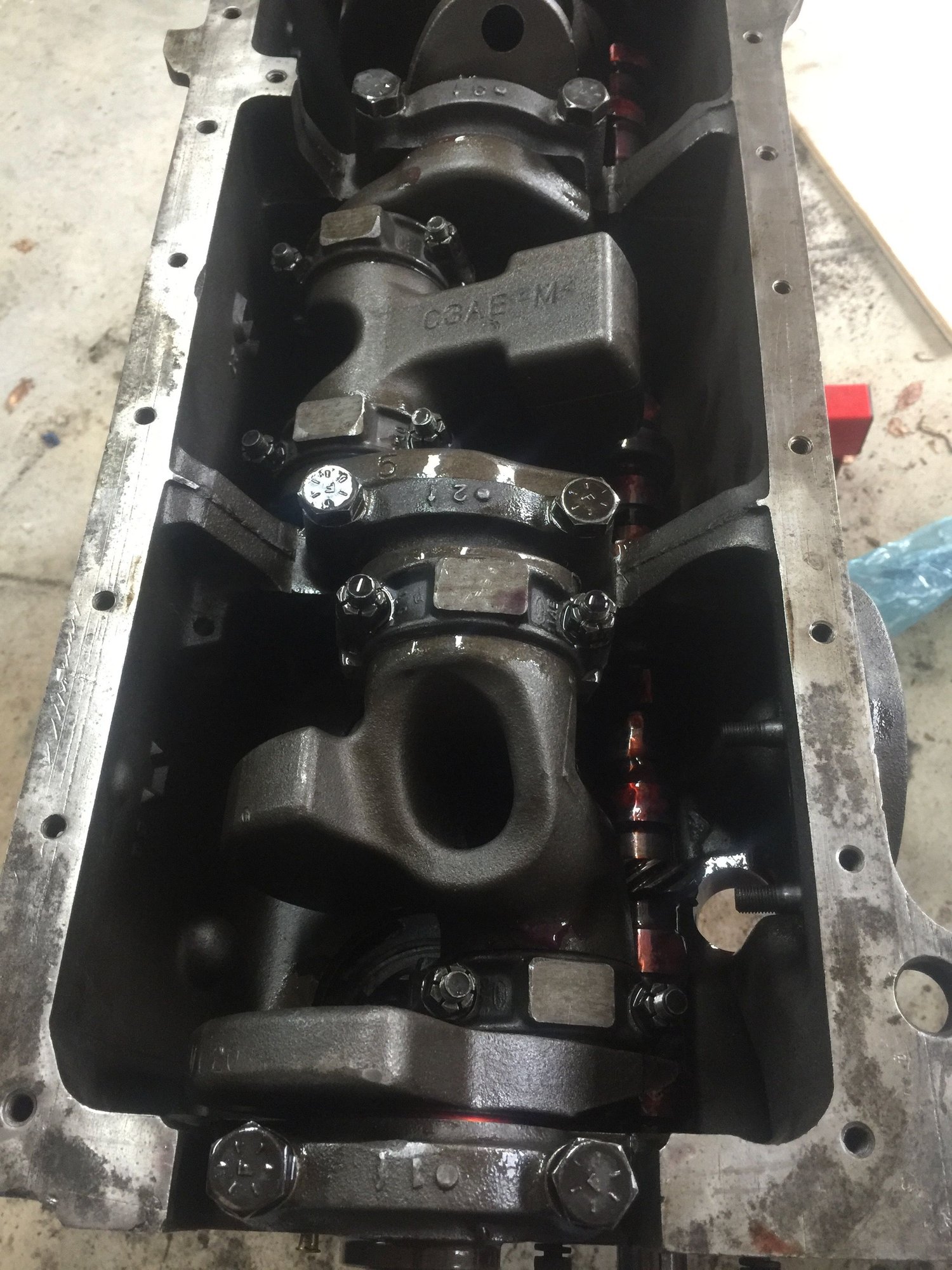

Well I found the thrust plate and it'll be here on Tuesday. Thanks for all the help. Been progressing as far as I can without it ... here are a few pics.
