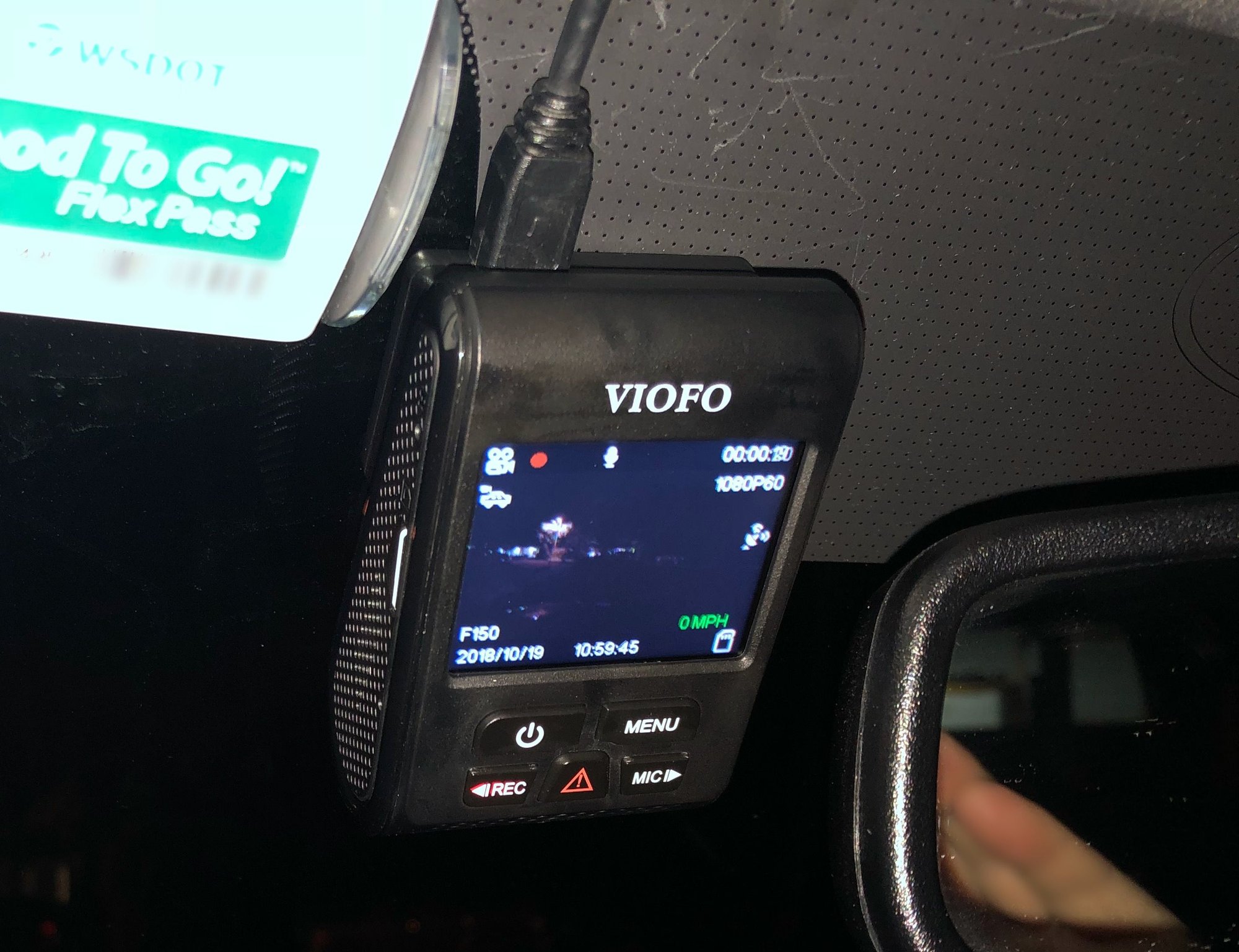

I installed this tonight. Been pondering a dash cam for a while now. Watching videos and going back and forth. One final Subaru merge-attack earlier this week and I decided to get one. I’m just not in the mood to even try and fight some of the attitudes around here if I happen to be in the way of someone merging thru three lanes at once. Only took me about 30 minutes to pull a few panels out and string the power up the A-puller and across the roof liner. I’ll clean up the power wire sticking out of the center dash panel some Saturday next spring when I have time and nice weather.
Just did a night drive and the video quality doesn’t pick up license plates, but I’ll call those out if needed. The still photos are actually pretty good quality.
