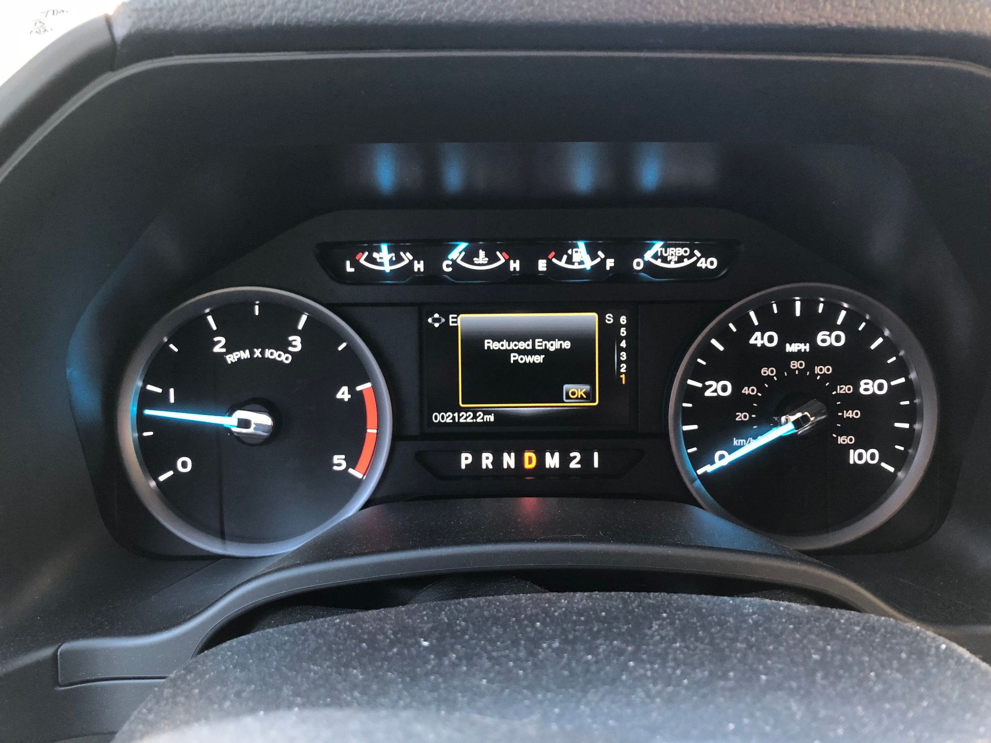

...Let it sit in the garage (45 degrees) over night and started rt up and ran fine but the check engine light won't go off. It's been a constant 10 during the day back home and below zero at night. I am going to get a set of filters tomorrow and change them to see if that will make the cel go off. If not it's gonna have to go to the dealer.
Changing filters won't make your Check Engine light go off. Once you get the "reduced engine power" message, the Check Engine light comes on and stores a code for "low fuel rail pressure." You just need to clear the code with a code reader. Any generic code reader will do, AutoZone will do it for you free, or FORScan can do it if you have that.
My Check Engine light was on, and I cleared the code myself. I've had no problems since, but we're expecting -28F this Saturday night after we get snow today.
This is the problematic warning (my Check Engine light came on almost immediately after this photo was taken:
