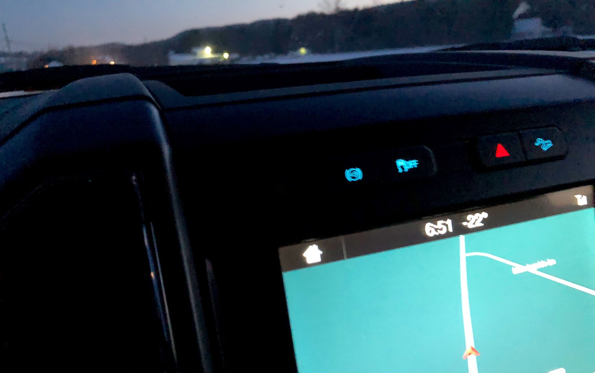

I snapped a quick pic of the temp on my way in to work this AM. Definitely a lot colder than what you experienced, bushpilot.
I think if you are only going to experience cold for a day or two, no big deal. It will thaw out! But if sustained, it can be a major problem. Properly treated fuel should actually prevent you from needing anti-gel. I suspect some fuel was not being blended with enough Arctic #1 diesel in my area of the country where sustained double-digit below zero lows are rare.
thats INSANE. Grew up in Virginia and never saw anything like that. Now that I'm in Texas I we think 30 (f) is insane.

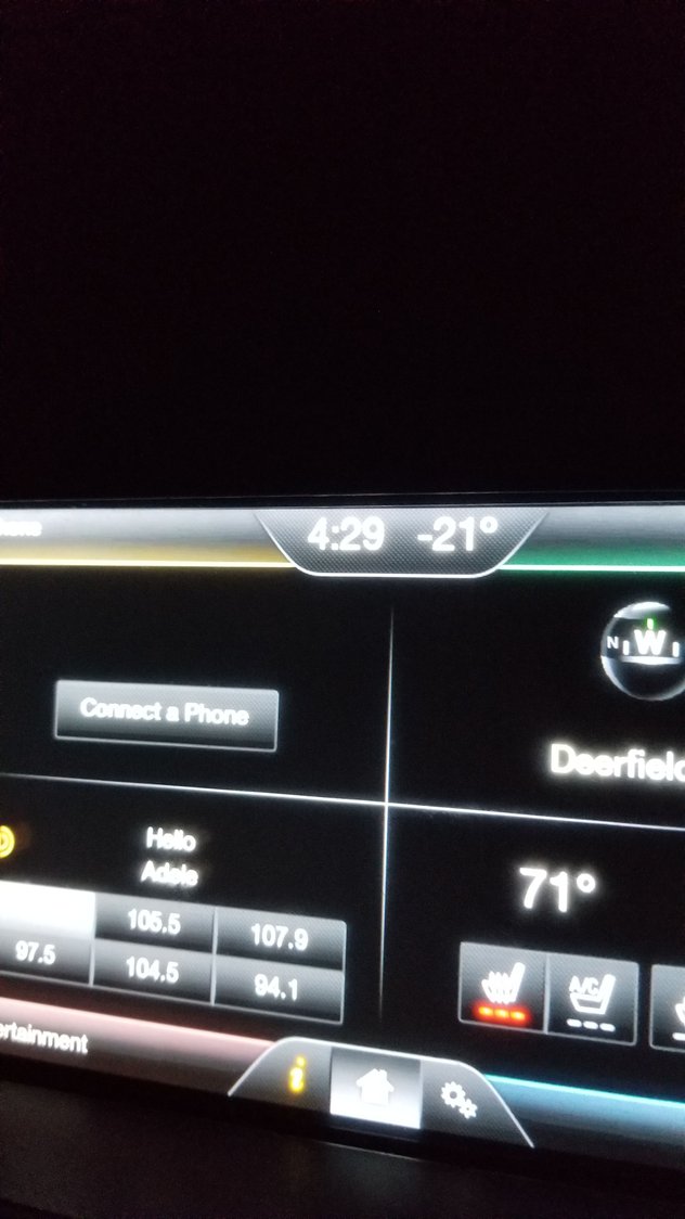

This is from my buddy's GF eco boost f150 when they were towing me to the garage.
