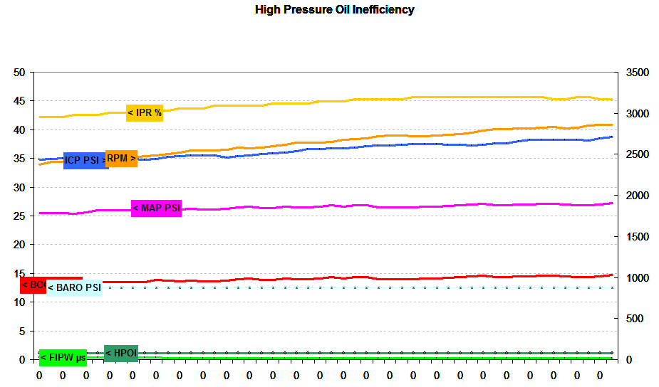

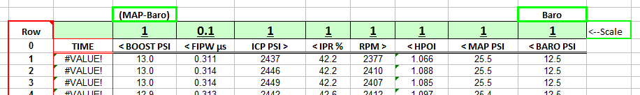

Unless a decimal on one of the PIDs is out of place, the HPOI shouldn't go over 1. Even with a decimal out and a result of over 10 - it doesn't look good. John - that's about what your HPOI was before you dropped in an HPOP, unless my memory is slipping from under me.
I remember the discussion and I moved it to be a 1-10 scale, else it disappears on the graph. All tied to the FIPW.
Here is a copy of the (10x) scaled data and one set back to (1x) original scale. The first is much easier to interpret, IMHO. Your calculations, just a 1-10 scale
Original (1x) data scale:
Data for (1x) scale:
Should be the same data interpretation but on a wider scale that fits the other data scales on the graph. Potayto, Potawto

OK... if we're fudging the numbers to fit the scale instead of adapting the scale to match the numbers - that works. I just needed that piece of info.
HPOP is marginal, so it is unknown what would happen if single-shots with big nozzles were thrown in there. I know I would budget for an HPOP if I were planning to power up - just in case.
