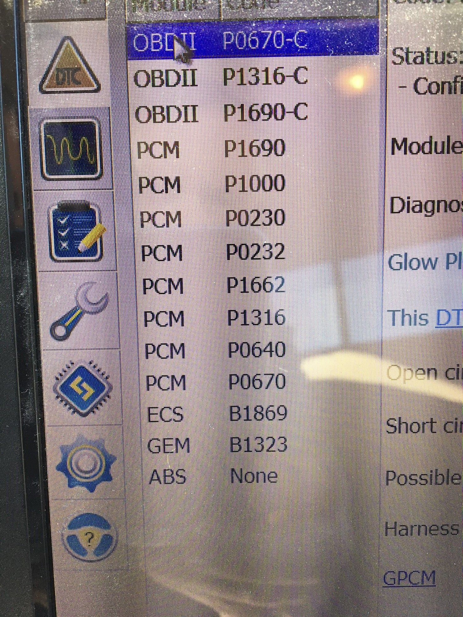

Here are the PID origination selections that Forscan give me when setting up the Dashboard.
I tried running both BARO settings to see if I could get any readings from the PCM but nothing.
Here's the current lists of codes that I have.

Okay, you're good on the connection part. Those are not communications protocols. They are the individual subsystems in our Powerstrokes. Each holds their own DTCs and built in tests that can be initiated.

So is there a way for me to "test" my PCM?
All of these codes have been with me since the day I bought the truck. The glow plug system is working and the waste gate solenoid and hoses are new. Power is getting to it through the harness so ???
The B codes are blown light bulbs.
I traced the Fuel Pump Circuit to see if there is a bad connection but didn't see anything wrong.
The manifold intake Air Heater itself looks to be new so my guess is wiring or bad solenoid.
The IDM EN circuit I have no idea how to proceed in troubleshooting that one.
Old Dec 29, 2017 | 09:33 PM

To prevent talking out the "wrong end"... I reviewed my copy of FORScan, updated it, added the Android version to my new Google Pixel 2, and went through the screens on both devices.
FORScan doesn't trouble you with the needed protocols, it's automatic. This makes sense since it's for Ford and Mazda, and nothing else... so it doesn't need as much input from you the way "one size fits all" apps do.
Looking at your list of DTC codes, your truck wouldn't run if any one of a number of those were active. Weird codes build up in the PCM memory over the course of years and scenarios, and they just need to be reset before you start troubleshooting any active DTCs.
