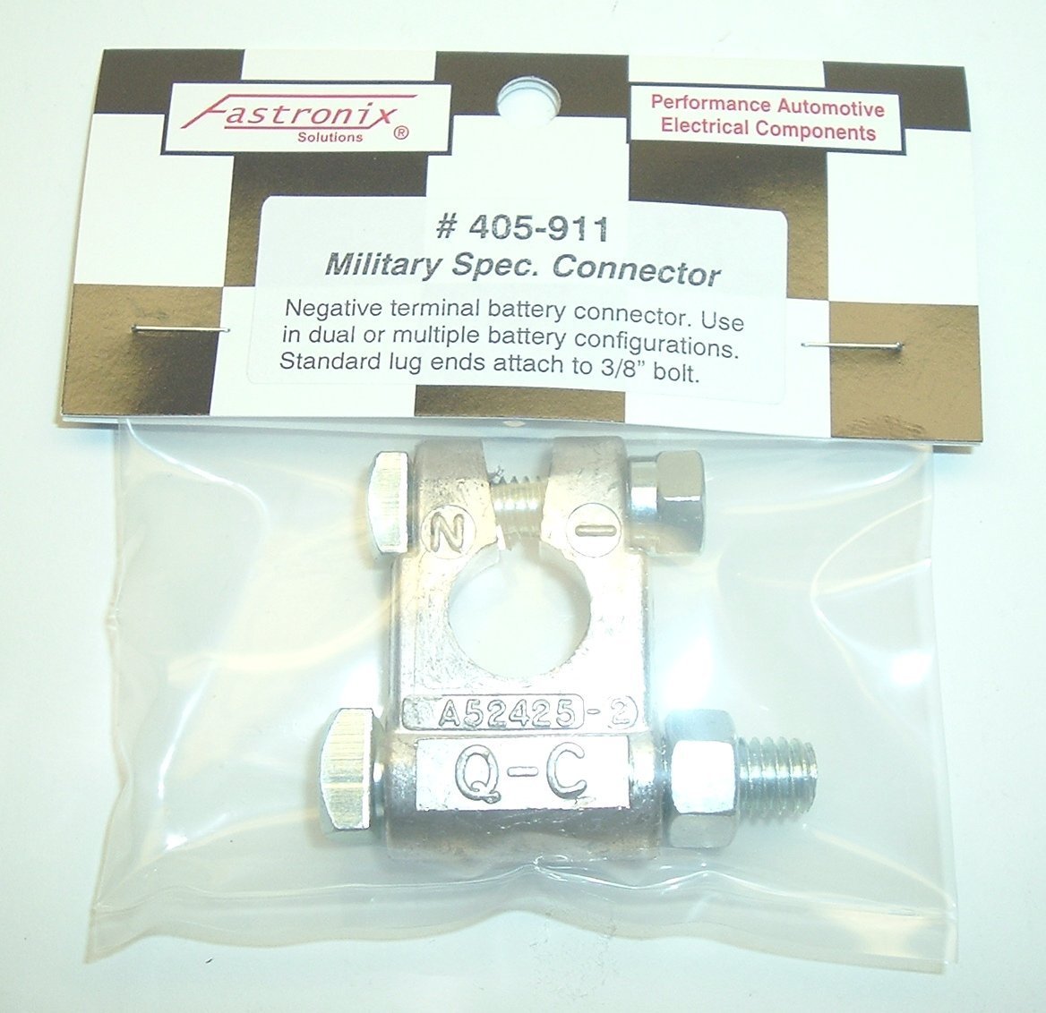

I bought Fastronix Eyelet Style Battery Terminals, to go with my military style battery clamps.
