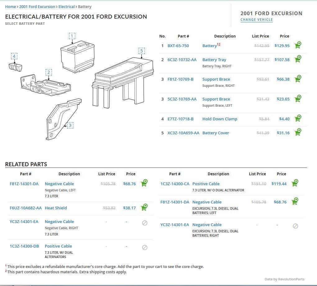

It has been obsolete for years but I am looking to replace the negative cable on the passenger side. I really would rather refurbish my chewed up ends rather than to get a junkyard one but my first preference is to buy a new one. Anyone know where one can be had or is substitution ok with say one from a Powerstroke 7.3 truck?
YC3Z14301EA
TIA

I just replaced both of mine a couple of months ago with new ones. Not sure why you can't find them. I think I bought them from RockAuto. I get most all of my parts from them nowadays.
http://www.rockauto.com/en/moreinfo.php?pk=381959

Would you know if another one would fit from a later year?

Both the negative? I couldn't find the right one on site. Any hints

F81Z-14301DA & F81Z14301CA
Did both cables fit? Reason I asked is that the DA part supposedly goes to an F350 or F250. Parts guy at Ford wasn't sure if it would work for the Excursion.

They have been on my truck for over 6 months. Yes, they fit fine.

Feb of 2016, I ordered 2 of the avail NEG cables for my 7.3, and used them both left and right, I made the body ground wire separate, which was part of the original pass cable assy.. I think it was the drivers side that was avail, I just tucked the extra slack, which wasn't much to the side of the pass battery. Just a thought.

You can't get 2 negative cables for the Excursion today. I think you mean you got 2 negative cables for the 7.3 that were meant for the F250 or am I reading you wrong?

I usually order per application for my year, Ect.
My receipt from 03-02-2016 shows I ordered 1 of 1C3Z-14300-CA which is the complete poz cable assy.
And 2 of F81Z-14301-DA which is the left part number
The shorter right one was discontinued when I bought these.
Those cables are still showing avail on the OEMford parts site, and are shown as the correct parts for my VIN.
Hope that helps out.
