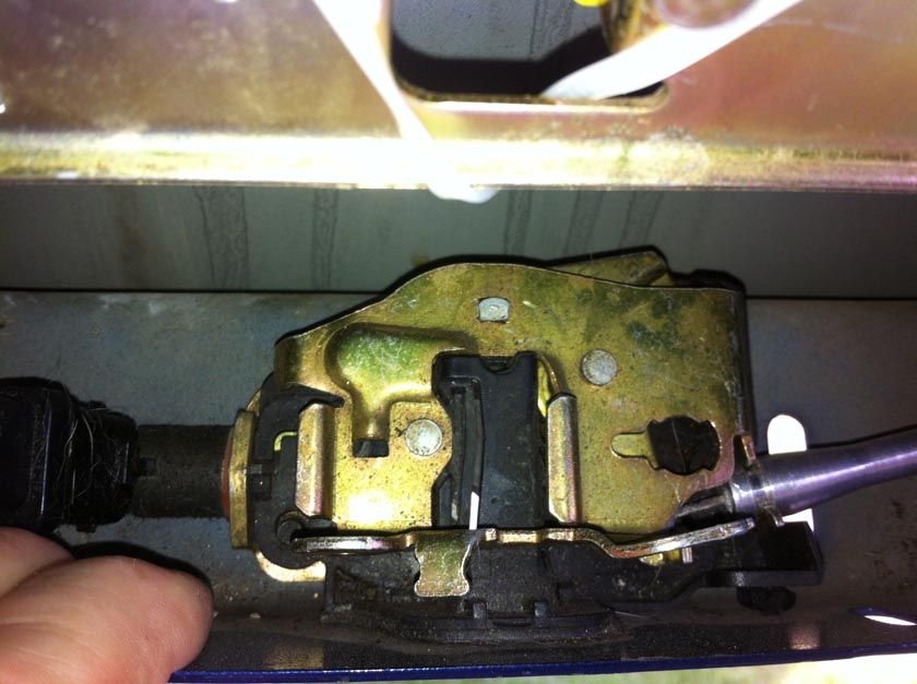

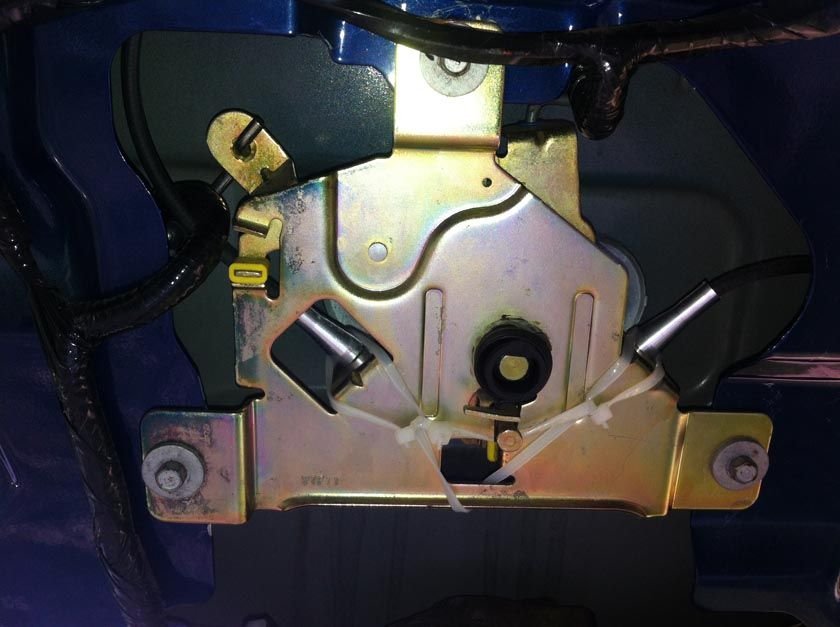

Door/Window Actuator
Actuator from Below
Above Latch
First shot is the mechanism inside door and behind the handle that opens the door and window. The silver thing on the right is the prosthetic cable end I installed just like the guy in your video. I zip-tied it into its cradle just to make sure it didn't come loose.
The second shot shows the same mechanism from below. If you look just inside the blue paint at bottom left, you can see the prosthetic cable end. In the dead center of the photo behind the gold metal you can see a little arm with a slot in it. That slot is what catches the ball on the end of the cable.
The third shot is the latch at the bottom of the door. You can see the other prosthetic cable end at the bottom right sitting in its cradle. There is a similar slotted arm to its left that catches the ball at that end of the cable.
The cable runs inside the door body. Good luck. I hope this helps.
