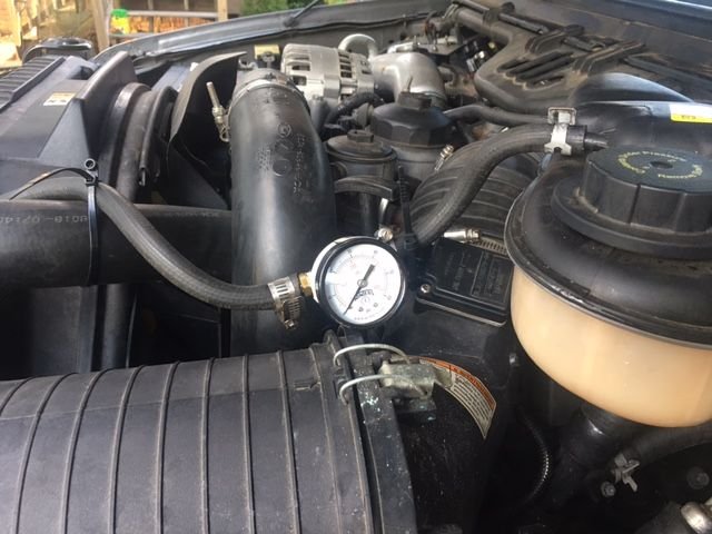

You can also pressurized the coolant system (only to 15 psig) to check to see if it holds pressure. You can use one of the vent hoses on the degas bottle to add air and to install a pressure gauge.
Make sure the cap sealing surface is smooth and is not warped and does not have gouges in it.

Put one of these in your degas line. If it gets above 15 psi, I think it still may be a head/gasket issue, or as has been said, coolant capacity with the mods may not be sufficient.
Also, I run my coolant just a little low, but watch temps like a hawk. It has been noted on the forum that putting in too much will make it puke.

I will be adding one permanent in the cab, I can't do it right now. How would I go about adding coolant capacity? It passes the exhaust/gas coolant test. With bad Gaskets, 2-3 weeks ago it failed/ the color changed. We replaced the head Gaskets and studs, then two days later the oil cooler went bad (again,3rd oil cooler in 2-3 months). Now I have had the truck back for 3 days, and is still puking. Coolant is checked daily, only filled to the min level, I had to add a gallon of coolant yesterday, i have not driven it yet today.

Update: I managed to put pressure in the system using my home compressor and turning the air pressure way down to 14 psi, at 11 psi the cap started hissing.

cap needs to hold to 16 lbs, get one at napa,advance,auto zone or any box store, retest,we found several new ones bad also.
