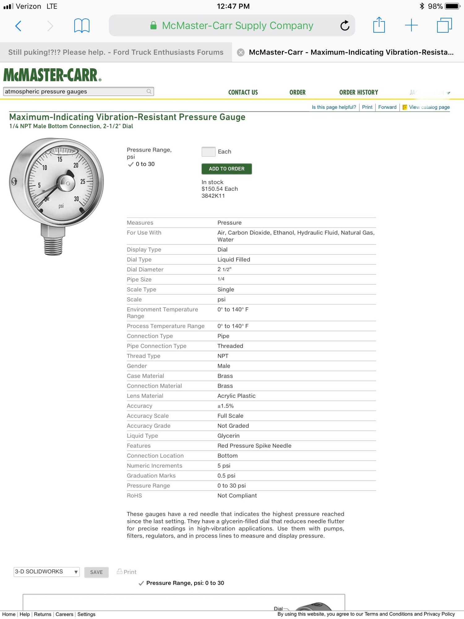

I set up a simple 3/8” Tee so I could install a pressure gauge in both vehicles to check how pressure was holding. I only takes a minute to install, but now it takes longer since I installed the gauge in the truck and have to pull it for the LS.
Pressure gauges are most accurate in the middle of their range, so I have a 30psi gauge. It’s accuracy is 1.5%, again middle of the range. Harbor freight it isn’t.

Jack,that the gauge ive used for years,even to ck other gauges with,i also have teed into the line and it stays in my trucks, this is realy important if you tow alot building more pressures than not towing.

Yep, it’s a good gauge. I used them (in another range) at the facility to run vehicle-stopping distance tests measuring hydraulic pressure before going all electronic. They were a good gauge and we rarely had to recal them against our $2000 calibrator.
And I do the same, used it to check cheaper gauges.
