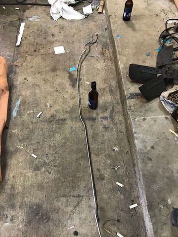

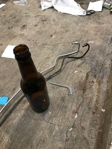

This is my $300 tubing bender. That’s right, a beer bottle. It took 12 to find the right one.....<br/>
A little tight, but I like it.
Not Ultra quality, but not bad for a first timer.

Looks like an empty bottle works better than a full one... right?

I needed color coded bottles. I think I spilt more than I bent.

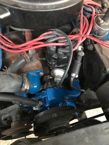

A good status report Stayton got his water pump all put back together. I couldn’t find a water bay pass tube for the 360 on short demand, so I repurposed one for another vehicle. It’s a 5/8” metal tube I cut with pipe cutter and a hacksaw. RTVed the manifold for lubrication and tapped it in. I sure hope I never have to replace it.
