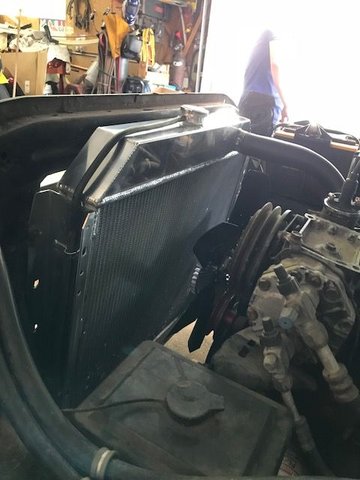

After flushing the block and heater core we installed this as well as upgraded to a fan clutch
Looks like a diamond in a goats azz, huh?

I too installed a 4 core, all aluminum radiator, off Evilbay, after shipping it to San Diego, and hauling it South in the back of my old F250 diesel... Works just fine, with new thermostat, and 6 blade fan.. Temp stays on 'C' and a little above even on the warmest days in Baja... you are going to love it..
