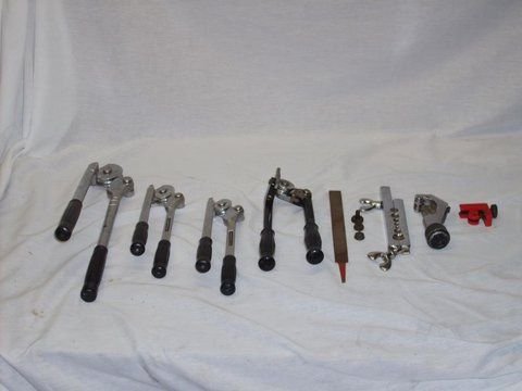

Thanks for you help Ultra! What flaring tool do you use. It seems as if I'm buried in this one to my neck.
From 1984 to 2009, I just had an Imperial-Gould manual flaring bar and double flare buttons. --somehow, the yoke for the flaring bar didn't make it into this picture but, you get the idea.
In 2009, I got a Mastercool hydraulic flaring set (p/n 71475). Naturally, I haven't used my manual flaring bar in a long time.
