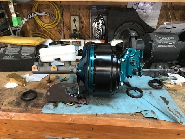

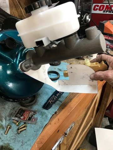

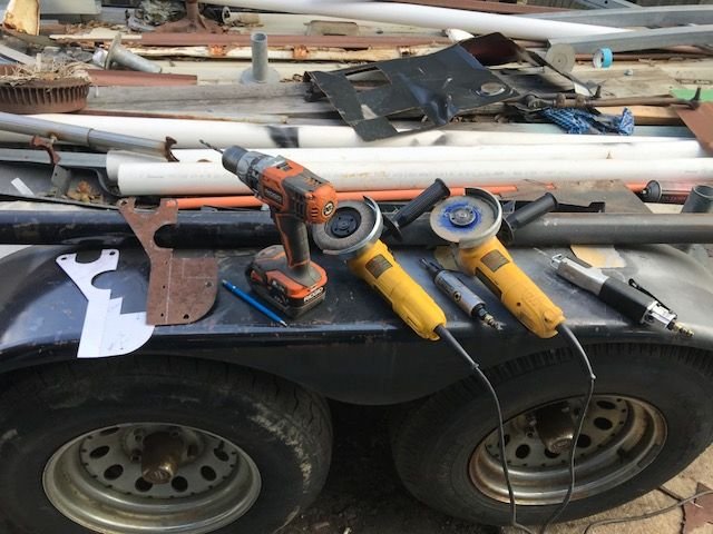

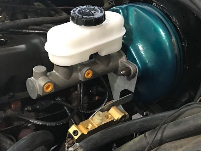

The template and tools I used to make the bracket
I can’t remember the order of the photos. But you see how the colors are all tiring together.
Along with the mock up, executed bracket and SET in place to see how it will all lay out. I think my off the cuff hair brained idea will work well.
I was going to weld the back corner, but the 1/8” Steel is pretty rigid. I drilled 3 holes in the bottom for water drainage and painted it “hammered silver to go with the M/C.
Steve, I need to know what the distance needs to be from the push rod to the plunger (?) of the M/C, please.
